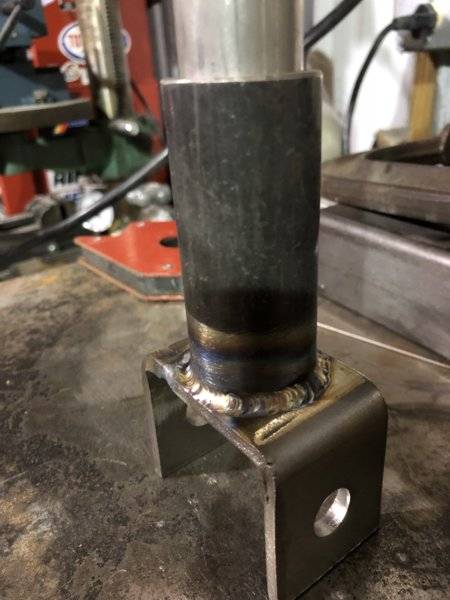

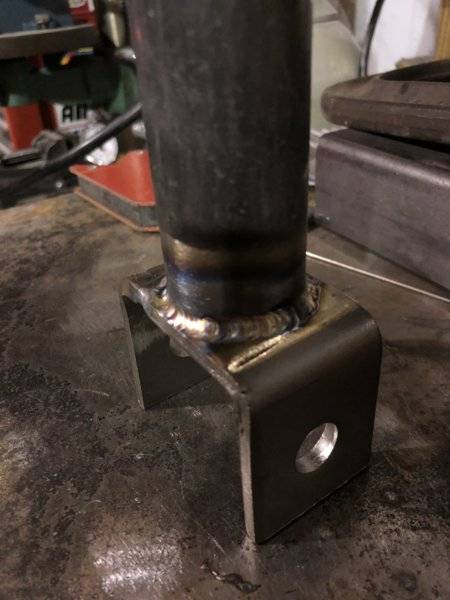

Chromoly, not bad at all for first run. I use the foot pedal primarily for non ferrous materials but on regular steels and SS like tubing and pipe as well as formed sheet metal corners etc. I just use the Hi Freq. and a rocker switch taped to my torch to start post flow, arc start, and ramp up the voltage to like 60 amps for 16 gauge and test it out +or- and usually you will use about 30 amps per 32nd of material but fine tune for best result. Your tungsten should be 1/16 at 2% thoriated is a good all around on those types of matls and up to 1/8" the 3/32 tungsten works pretty good and I use1/32 tungsten on matls down to about .025 to .030, then when you need to stop just ramp down and post. I have used most all types of power supplies in the field but the Millers were our favorites. My shop welders here at home are a mid 80's Miller dial arc 250 HF and a mid 80's Hobart beta mig 2. I would love to try out these new machines of today but I've been retired for 8 years now. Good luck Rod Burner. Oh yeah, don't drag start your tungsten!

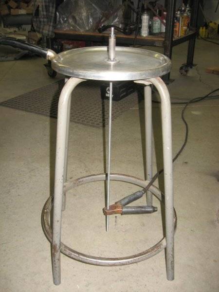

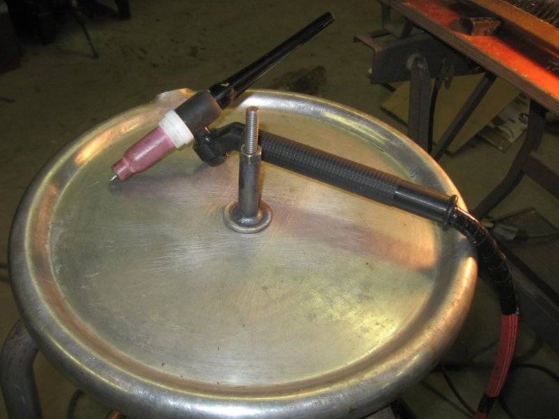

Hardest tig welding I did was using a rotary table that was speed controlled by a foot pedal. left foot table/right foot tig pedal. Now I know what it's like to be a drummer.

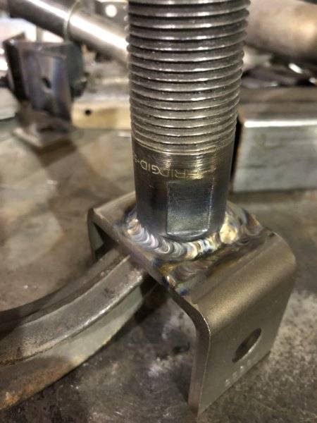

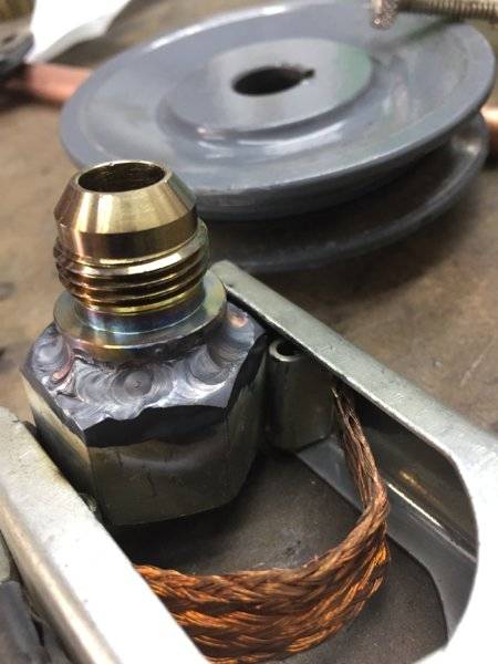

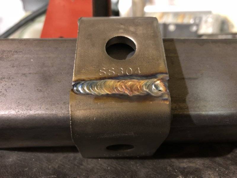

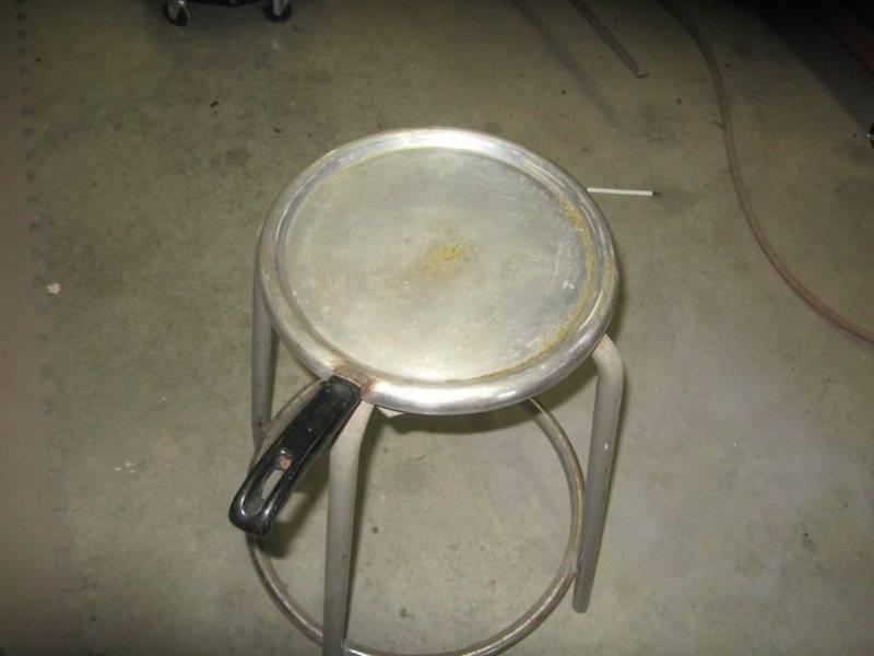

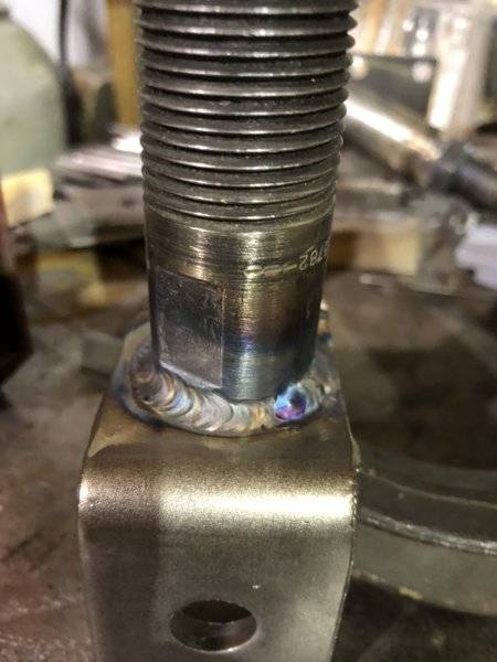

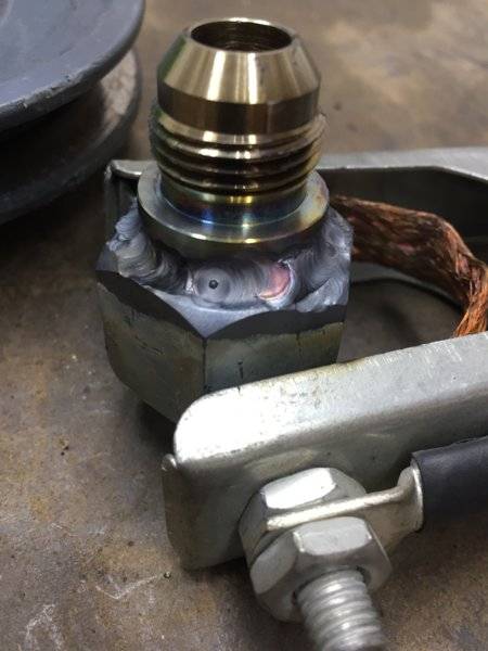

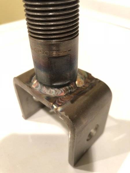

Nice, this is my "rotary table". My Mother's old pancake griddle attached to an old stool frame. I turn it with my arm while feeding filler at the same time. Making aircraft engine mount attachment spools here..

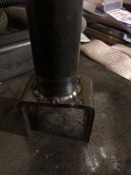

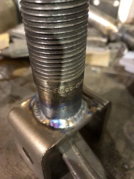

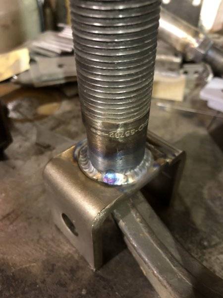

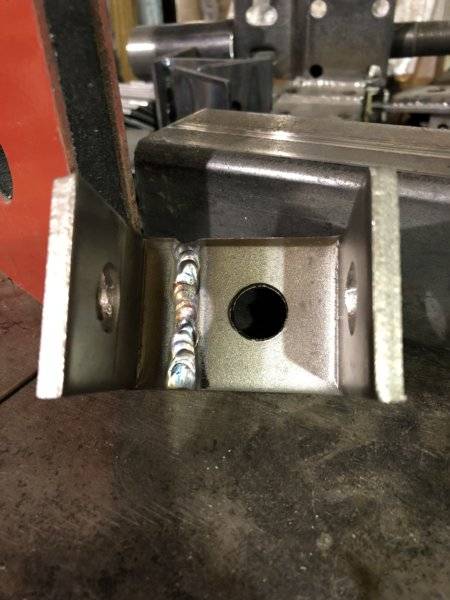

No filler rod on this. Stainless AN to zinc coated steel. I sanded off the zinc before welding.
CA9998D4-0E4E-40CC-8E38-996F66239513.jpeg 1B4DE05F-0F4B-44EC-8454-FF84A771C322.jpeg

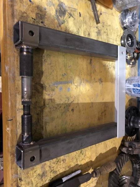

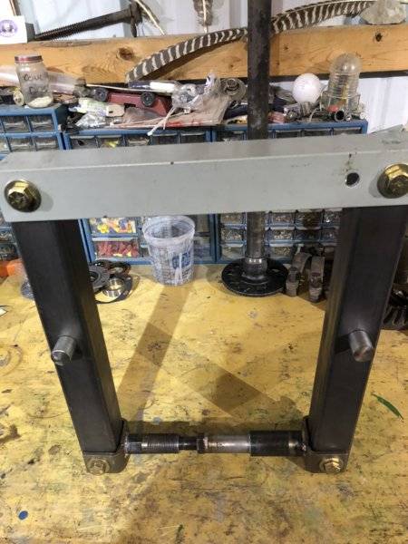

I should be back welding, either this weekend or next as we have to modify a header tube to fit my friends car.

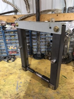

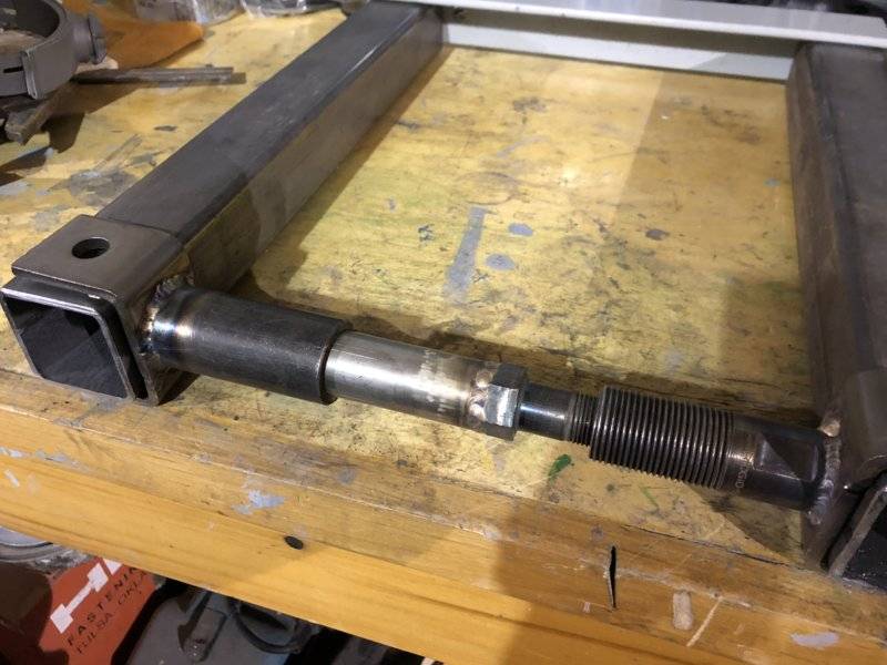

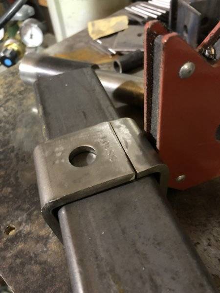

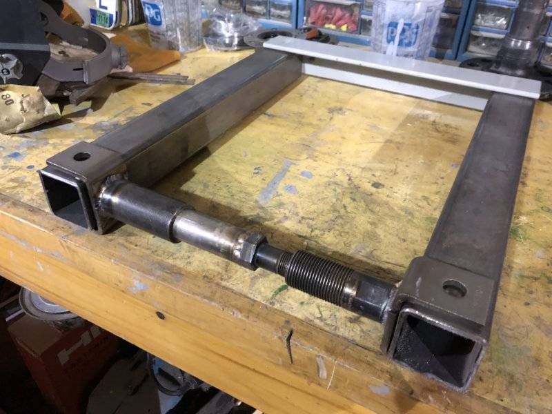

Just about done.
I may weld nuts on the box steel to thread the dowels into, but I tested it and it works as is.

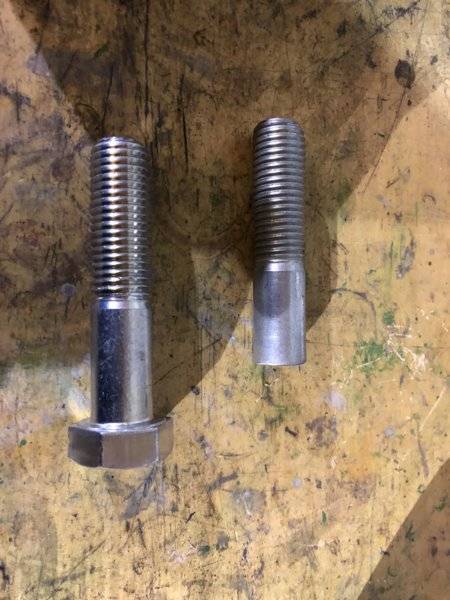

5C9C2284-5389-4847-9244-9DB272A0FF0C.jpeg 46F88D42-416B-455C-ABC8-2BCCAA3DFC0A.jpeg C6121CFF-009F-487E-A52C-22D4043A0433.jpeg 330DFB4A-793E-4E56-B5B5-B4FDA93E54AA.jpeg
