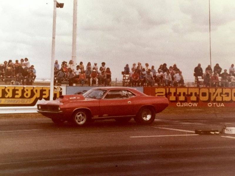

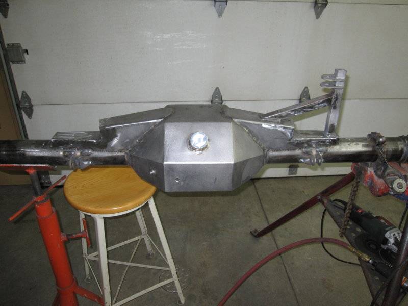

Watts linkage requires a anchored pivot on the center of the rear end housing, depending on up down travel determines the length of the pivot arms, the bars to frame pivot points must be parallel so the brackets for making this gets fairly involved. they are better in that they are more precise than a panhard bar, but in reality the panhard bar will address all the needs of keeping the rear end centered. my 70 Hemi cuda/race car had no problems with rear end sashay, in 1978 it was a 10 sec @ 128 MPH car (crummy low performances hemi Crane Cam. called the "no pop"terrible cam ,supposed t o be easy on valve train.) I never had a problem with the Crane RR296 @750 lift. though.
