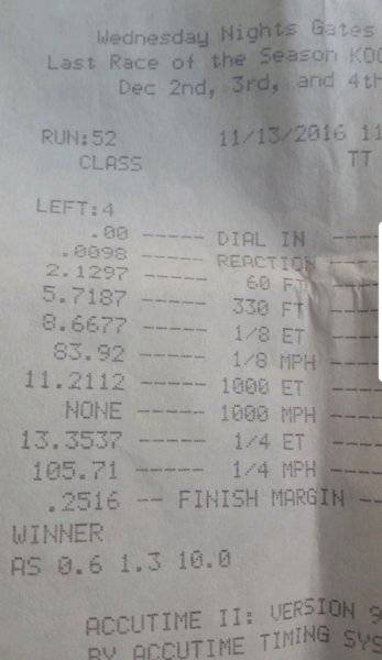

Obviously I need to do better in the first 60 feet.
This time slip was 2 years ago with a 3.54 ring and pinion gearset in my Dana 60.
I had just got my 315/35/17 Toyo Proxes TQ drag radials, and they worked WAY better than the T/A Radials I had.
I definitely need more track time! Other than being very busy with work, I had a problem with the top of the line Mancini pinion snubber I added, it bent on the first run I made, and on the 2nd run I had to remove it because it bent so badly it was rubbing on the pinion yoke.
I have a line lock that I need to install so I can clean the drag radials and impart some heat into them. I'm also considering getting one of these "clutch tamers" because it sounds like a great idea!
So far my best, most consistent launch technique is to ease out at about 1,500 RPMs and within a few feet stand on the throttle and go. That usually prevents wheel spin, even with the 4.10 ring and pinion gearset I have now, and with the 4.10 the RPMs climb faster. Still I know if I could hit the start at higher RPMs I could get a better 60 ft time.
I think my car should be running mid 12s, and you can see if I could cut my 60ft times from 2.2 to 1.8 that would get me into the 12s.
3 way adjustable Competition Engineering CEE-2730 rear shocks are new, and set to 50/50. I also just installed Viking 18 way double adjustable front shocks, but I haven't had any real time to play with them on the track.
I'm concerned that the factory leaf springs may be weak, because of the pinion snubber bending, I'm thinking the springs are really wrapping up. It's a real V-code Roadrunner, so it has the extra 1&1/2 leaf spring (or is it 1/2 of a leaf spring?) on the passenger side.
Eventually I'm installing a RMS StreetLynx or GERST triangulated rear suspension, and I am dead set on that. I know a lot of you are doing well with CalTracks and other leaf spring solutions, but I'm jumping in with both feet and going with one of those 2 setups.
In the meantime, what advice can y'all offer, and I appreciate all of your replies.

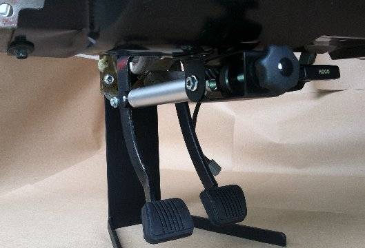

Here's the clutch tamer:
website: http://www.clutchtamer.com/
My timeslip:

Well, at a glance, the 60' time is telling me that you have no traction at all. I get the idea of "easing out at 1500 rpm", but that is KILLING your quarter mile times. My gut instinct is to put in some hardened axles + slicks and add a CalTrac (or other) rear suspension setup on the car & leave the line at 3000-4000 rpm???

I would say 13.3-13.5 at 105-106 is the norm. Traction off the line and in 1st gear is a struggle, and that is where I need the most help. My 60 ft times suck.

without seeing your car at the track
or good video & sound
especially good quality hi-def &/or slow motion stuff
it's all speculation
sorry to say it, not trying to rain on your parade
(no offense intended)
just spit-balling here, what if's
BUT;
your manual trans, or ability to work it
(don't feel bad most people can't do a good time/ET with a man. trans)
your clutch or lack of adjustability, to make the car work correctly
(an auto with a decent tire & converter, is far easier to hook)
the ability to get it to hook properly, not shock the tires but still hook hard
use of the proper launch RPM's
&/or
your tires 'lack of traction' (to stiff -or short/no wrap- of sidewalls)
(wrong compound or too stiff, not enough sidewall, absorbing the shock of a man. trans etc.)
(just because you have drag radials,that doesn't mean they are any good)
or your cars 'lack of',
'cars ability for transferring the weight, properly to get said traction'
is harboring your ET's
but your speed indicates/shows 105-106mph
that's about the right/correct level for an ET in the low-mid 13's
a car with that HP should range
(even a better S/S spring intended for a manual trans would help)
a better tire & rear suspension, better adj. shocks,
should pick up quite a bit of wasted ET
after a bit of trial & error
go to a test & tune not a race day
get back to back to back time for comparisons, changes
Maybe as much a probably 0.4-0.5 (tenths) improvements, at current HP levels
your top speed doesn't indicate much more HP or much more gains
you need another appr. 200 - 300hp to get 120-130mph thru the traps
but the ET can be improved by the 60'-300' ft range for damn sure
a little improvement there makes for a better ET
1.60's @ 60' aren't out of the range at current levels, if it works correctly
1.20 -1.30's 60' times are way bigger HP levels
& the cars suspension all working much better
you can't get there with what you have now,
unless poss. the car was working perfectly
with no wasted motion & traction, good track & RAD (good air) etc.
MPH = HP
ET = is a total function of the car working properly & using it's HP efficiently
I think the ClutchTamer is a great idea, and once dialed in should help by taking a major variable out of the equation, that being clutch slippage becoming consistent, allowing me to focus on traction, and if I get to the point of dead hooking (no tire spin) that is the ticket.
It's just getting to the point of no tire spin being the challenge, without having to ease off the line.

It does make sense, and I've experienced it in a "much worse" case scenario. What I mean by that is when I was leaving the line by easing out just the first few feet in my Roadrunner with the 3.54 ring and pinion, and 6 bbl, it would still get up and go pretty well when I stood on the gas and that is WAY BETTER now since I installed the 4.10 ring and pinion gears. What I mean by "much worse" case scenario was my 89 Conquest TSi with the 2.4 L inline turbo 4 cylinder. Once I put the Nitto drag radials on it, they would stick-big time so the only thing left to keep the motor on boost was slipping the clutch, and that is really hard to do consistently! So I would either not launch as hard as I could because of excessive clutch slip, or what happened most often was letting the clutch all the way out too soon, which would cut the boost and the car fell on its face. At least the 440+6 has lots of torque, made better with the 4.10, but like I referenced twice, I think the Clutch Tamer may be the ideal solution! I am concerned about how badly it is going to wear my clutch, but at least it should be fairly consistent once I get it dialed in, and what the heck-if I have to upgrade my clutch disc setup or maybe just replace it more often, that is the cost of racing!
Right now I have a "street strip" McLeod disc (not puck) and a 3,*** pound diaphragm style pressure plate. I am definitely going to get a clutch tamer hydraulic pedal release speed controller and set it up to where it only slows the release in 1st gear, off the line. You can do that according to their website by using a drop out spacer, otherwise it would slow the full release every time I pushed the clutch in, and I want full engagement when I bang 2nd, 3rd, and 4th gears.
I think it's a great idea and hopefully won't smoke or glaze the clutch disc too much or too quickly.
