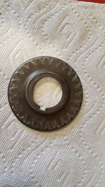

I had the oil pan off replacing the rear seal and noticed this plate with chips in it. I believe this is the chain oiler is that correct? and why would it be getting damaged is it installed correct?

It appears that the oil slinger was installed backwards. Not a chain oiler, helps to keep oil from the front seal.
Thanks for the reply,
That’s what is was afraid of, I’m sure it can do some major damage if it continues to come apart.
I have one that looks just like that. I didn't notice the appearance until I was re-installing with a new chain sprocket set. The slinger was installed correctly when I took it apart. I grabbed another slinger that I knew to be OEM. The OEM part had a larger offset between the surface that is sandwiched between the damper & crank sprocket and the flat surface around the chain links. Result is the chain rides against the slinger.
This piece was installed correctly, not backwards.
At the very least, you'll have to take the oil pump apart and inspect it. It probably
inhaled the metal debris and damaged it. If not, you'll have peace of mind.
I'd sure pull the timing cover & get a look at the slinger. My oil pump was good, no damage. Metal dust must have been very fine.
Hmm I wonder how much clearance is "safe"? Mine has right about .030 between the chain pins and the slinger. It's a repro.....
Hard to believe repops would be different enough to cause that problem but it wouldn't be the first time to see simple stuff messed up.....
I put the damaged slinger next to the OEM part and the "dish" of the OEM slinger was visually deeper. I don't recall any difference year to year on slingers. But....?
Have about 7 of them from various years and they all are the same.....
