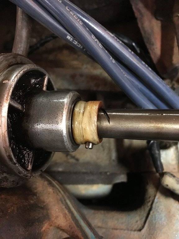

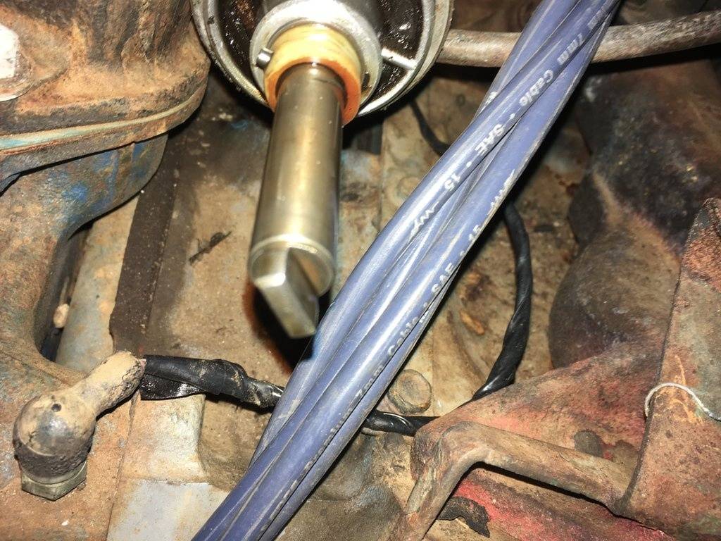

I just noticed there is no gasket between the block and dizzy--I'm guessing there should be one. Here's the shaft. That white bushing looks worn.

Rebush your dizzy and adding a gasket should help.
Agree with above but here's a thought, if an old dist. you cud have little ridges built up from the holddown clamp, if you moved timing a little u could be sliding on the ridges. Far out there I know, but possible.

If this happens when you snug it there's only two parts that can move, the distributor body or the shaft. I doubt you're allowing the body to slip with the tightening clamp so that means the shaft is moving. If that's the case it is caused by the helical gear engagement between the distributor shaft and the cam gear. There are only three possibilities with this scenario, the gear is worn, the gear has shifted or the distributor shaft is twisted. 20 degrees is a $hit load of change so the gear must be dropping lower on the cam gear or there's severe wear in this area. It is possible that your shaft is bottoming in the oil pump fork shaft. Maybe time for a new distributor.

After playing with it, I got it to shift much less when tightening, but more than it should. Im going to get a gasket and replace the bushing and it should be better.

Does anybody know where I can get a new bushing? Mine is nylon with a pin through the middle of it. Local auto parts store made a phone call and came up empty. They had brass ones with no hole in them. Looking online, but coming up empty thus far.
There's a member that rebuilds distributors, I bet he has them.
The distributor body has two metal bushings in it (one upper and one lower) but that piece you're referring to as a bushing is a spacer. I've never seen any side wear on them before. What is making contact with it? I know they get a bit brittle with age and can crack if you try to re-pin them, but that wear on the side is weird.
