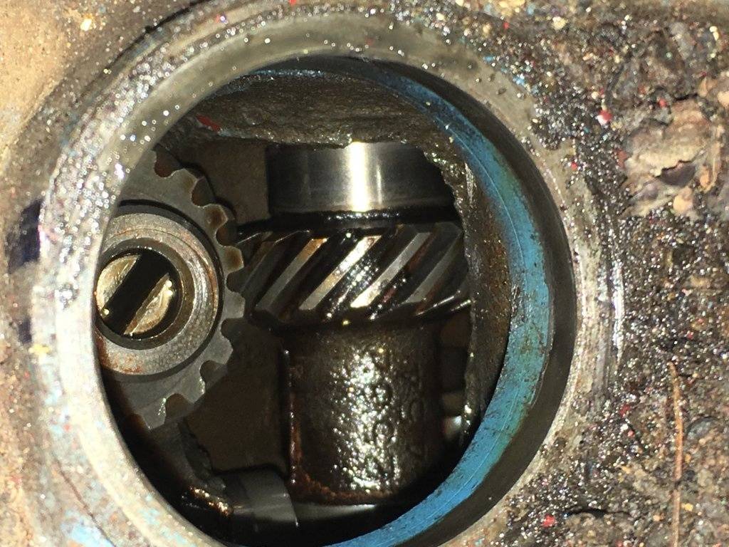

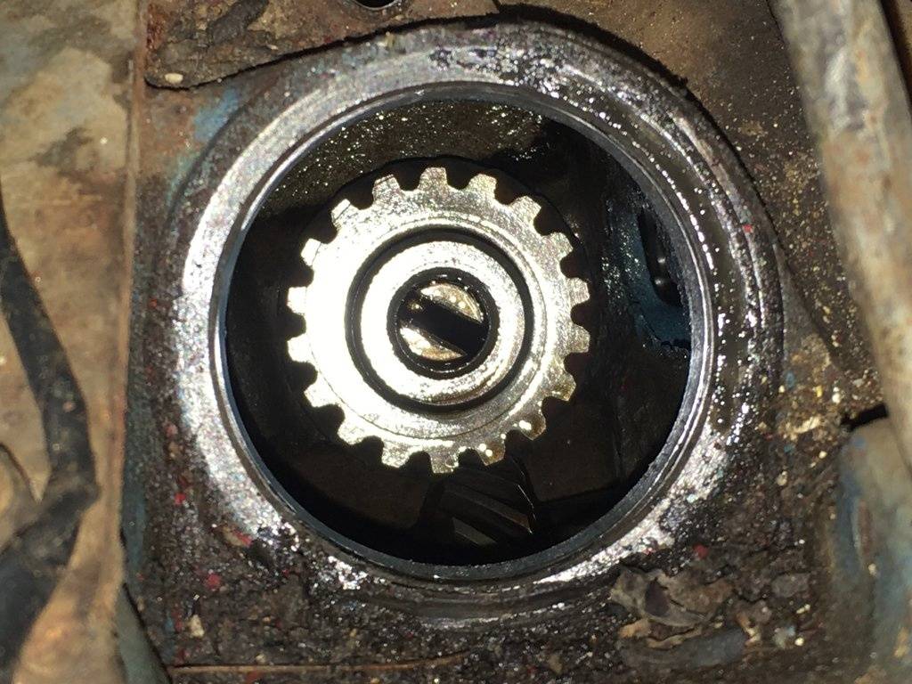

Two things to check would be the base of the shaft perhaps bottoming in the slot of the drive, and pull the oil pump drive and see what condition the bushing for that is in. S0me distributors used an O ring so a gasket may not be needed, or it might... Regardless the tang should not bottom in the slot.
