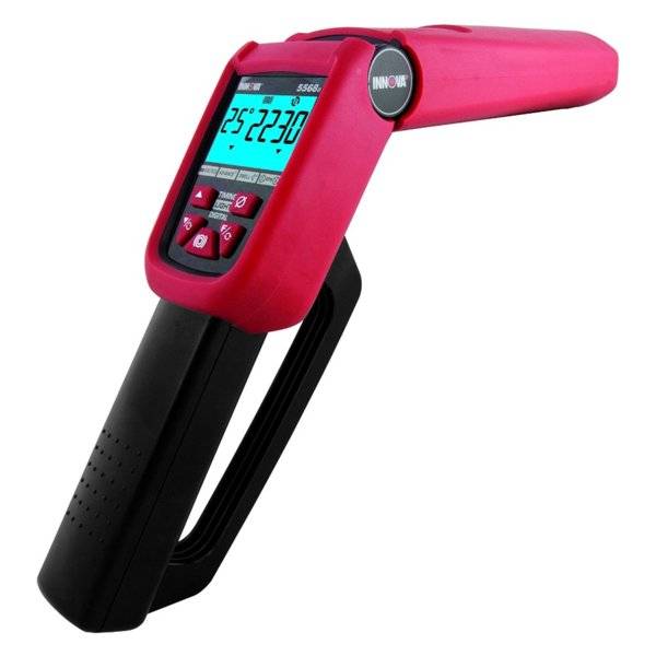

I have this one and it works great.

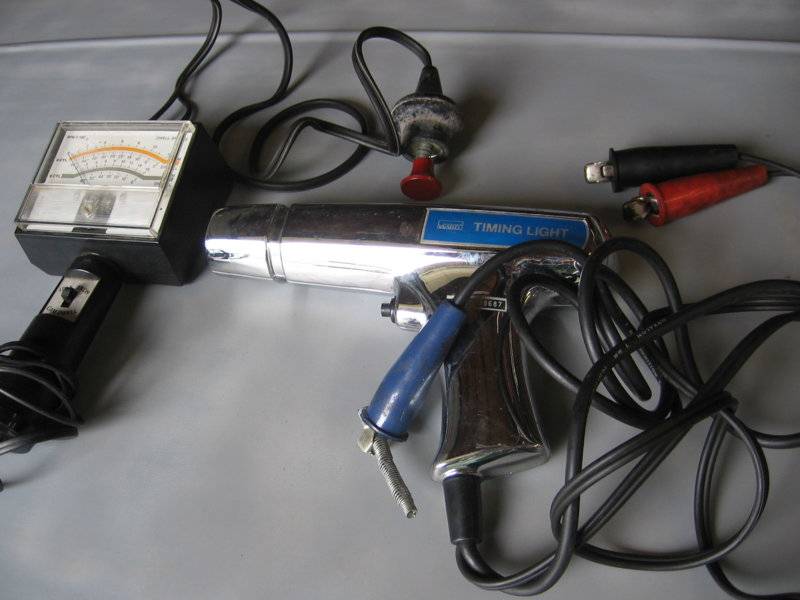

Old school like this one ? Is this the type you mean for MSD ignition ? ? Its a old Monkey Ward.
