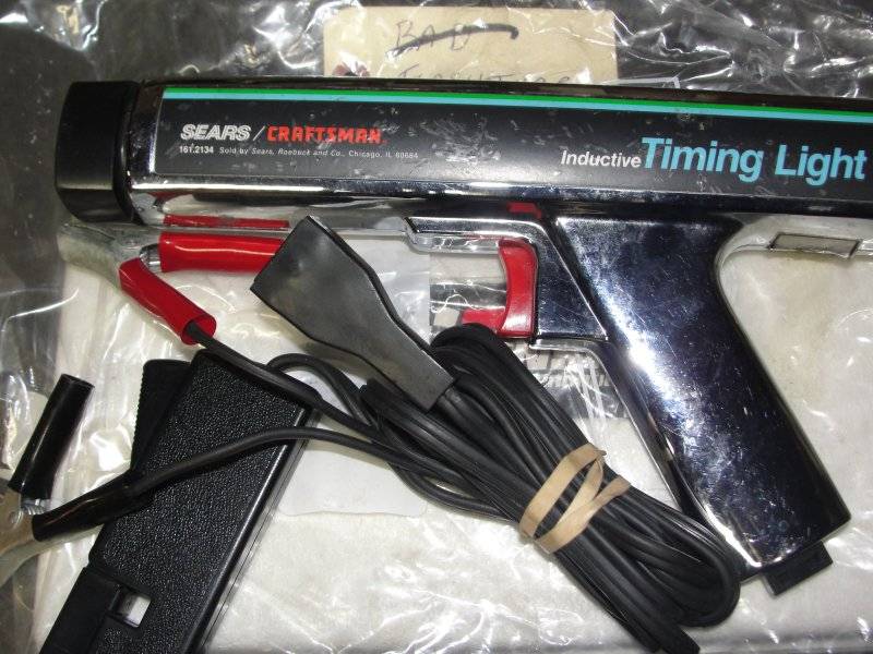

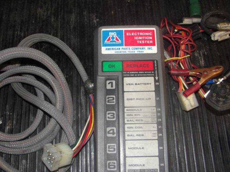

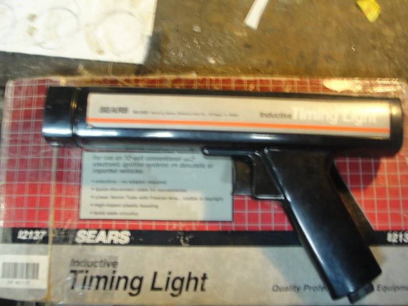

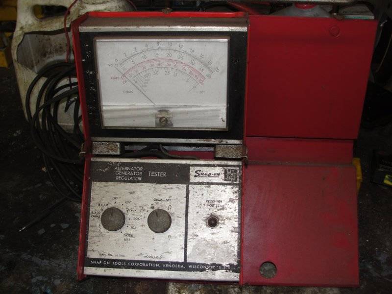

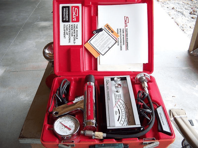

@HALIFAXHOPS usually has some quality lights. He knows what works.
Still have a ton of them all older analogue. Lots of tach dwell meters also.
Have a few of these sets also all calibrated.
Just PM me with your need.
