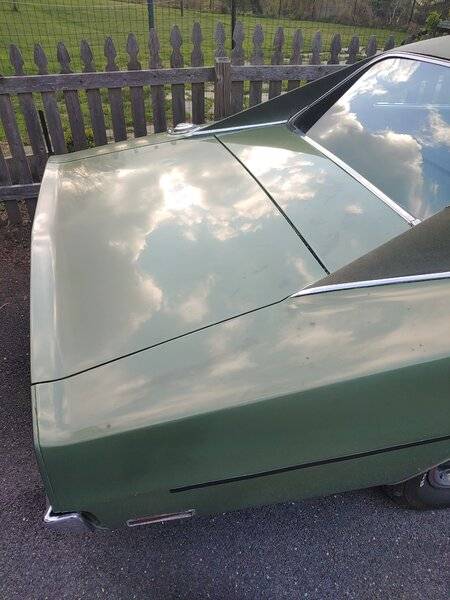

I'll have to try that for maintaining the finish. I seem to have found a happy compound combination - I'm VERY pleased with the way things are turning out now that I have the 110 and 210!
Now I just need to find a source for less-expensive bonnets for my orbital sander...
One more shot, in daylight when I got home from work.
Did I mention I'm thrilled?
