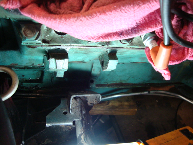

Use a 4X4 block of wood at the rear of the engine on the opposite side of the starter. There should be a ear of the block that you can contact.
im changing out my driver's side motor mount right now, and i used a flat, wide piece of wood on a floor jack right on the oil pan. i've done this a bunch of times, and no problems. (stock oil pan btw)
you can see the block of wood here...

I've lifted plenty of engines by the oil pan with a block of wood and no issues. Just make sure you spread the load out over a large area.
