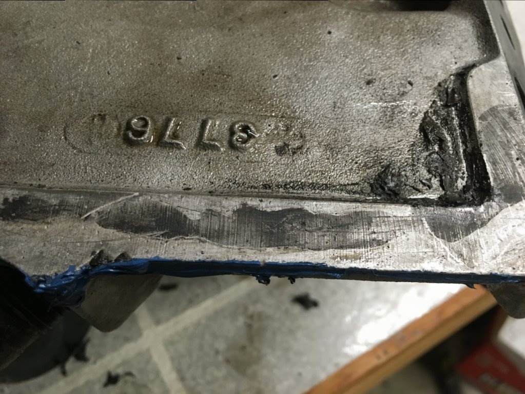

Got it out. It put up one hell of a fight. The gap in the front was large enough for a gasket scraper. Used that to pry just enough to get my putty knife in on the sides. Surprisingly, there wasn't any RTV on the sides. Just a blue FelPro and a metal one.

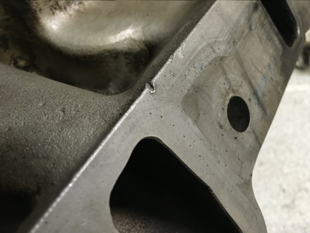

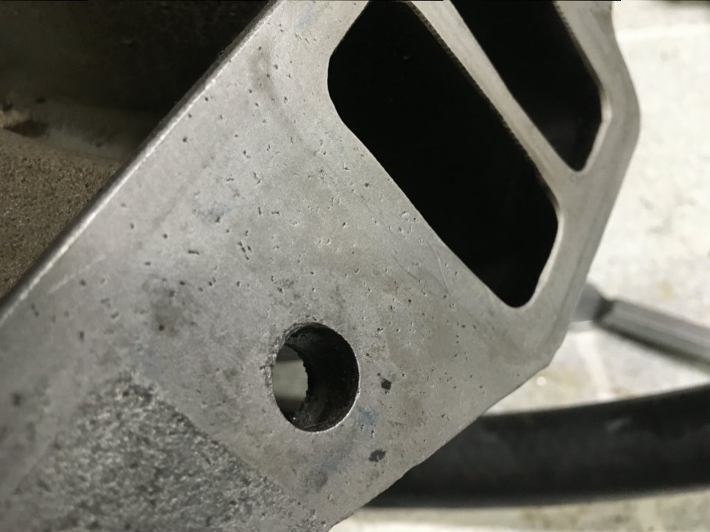

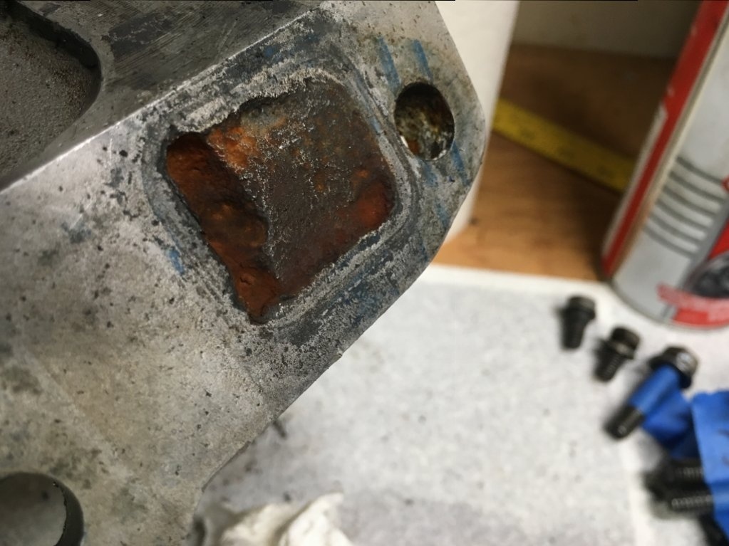

Anyone have thoughts on the condition of my manifold mating surface or how to get the rtv residue off without killing myself with carb cleaner fumes?
Take it to a machine shop and have it machined flat if you want.
Get a scotch brite pad on a arbor disc, put it in a cordless drill, and clean it off. Acetone should take it off as well. Many ways to clean the manifold
