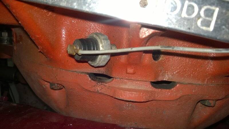

Hello, I searched around but not seeing any matches.

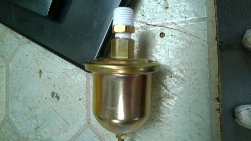

Installing an electrical oil pressure gauge (SunPro) and it comes with the 1/8 NPT bell shaped sending unit.
My 440 currently has just the smaller "light sender" in the drivers side port.
As is obvious, not much room for working in there. So I am wondering from those who have done this swap with the motor in the car, what tools came in handy here? The factory sender doesn't seem to have the ability to put a wrench on it like the bell shaped unit. The body seems almost like a socket would fit.

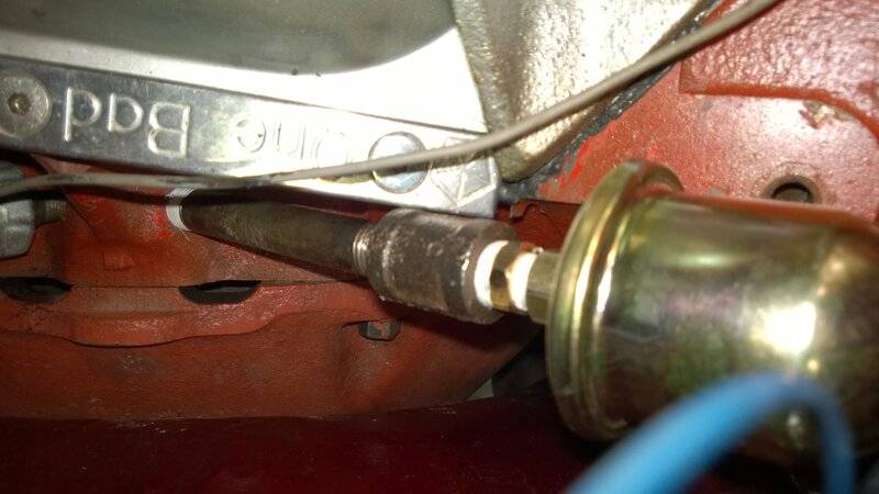

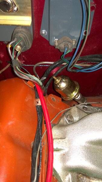

On this forum somewhere is my own exploits at "custom" sending unit installation in the 1/4"NPT side:
I left the factory idiot light sender in place and pulled the plug out of the other 1/4"NPT side...
Used a brass bushing to get the new sender up to 1/4" NPT...
To combat the fact there is no room down in there for the new sender, out came a 1/4" brass pipe nipple
and coupling...
Got it installed so that it clears everything. Looks funny, gets questions at local shows. :) :thumbsup:
