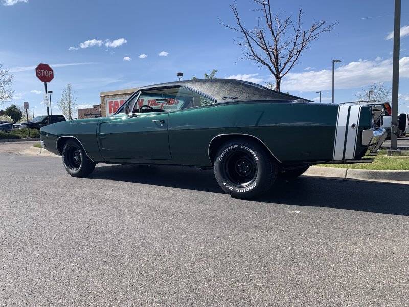

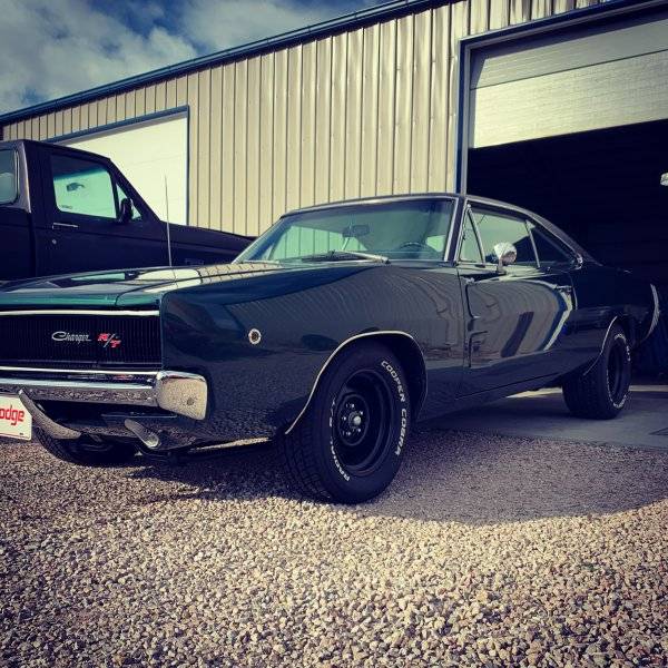

And, I would look at Cooper Cobras WAY before I'd buy T/A's. Better tire, probably forty bucks cheaper each.

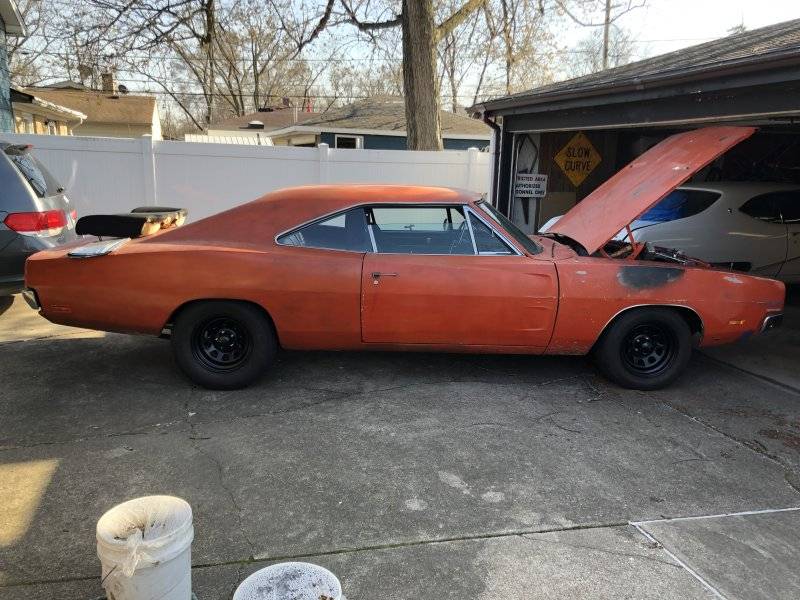

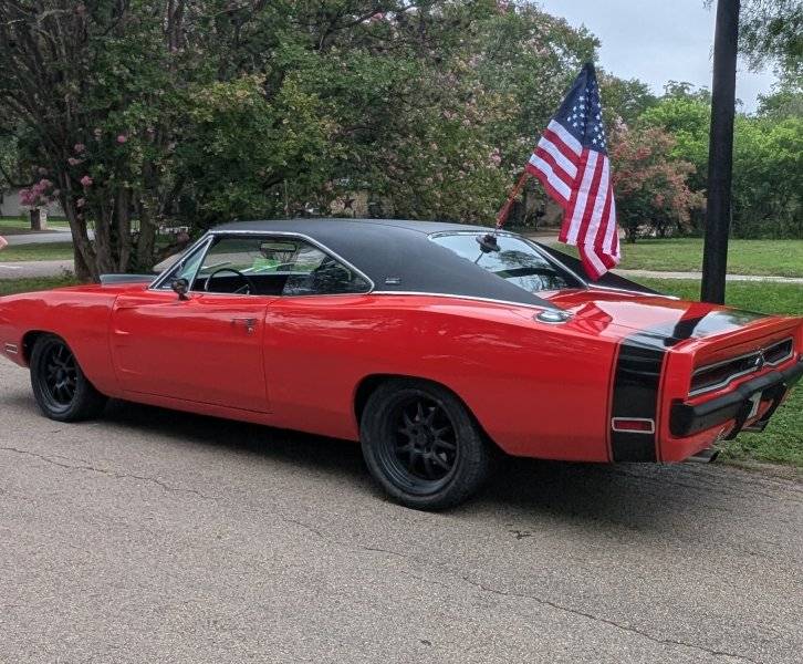

I have 18" wheels on mine....
I can't run a wheel smaller than a 17 due to the front brakes. I wouldn't anyway. I love the look of the wheels and tires.
The 15s mean a much taller sidewall and more tire squirm in the turns. No thanks!
My wheels have a 4 3/4" back spacing. The rears are about an inch from the wheel well flange. If you go with a different wheel, I'd aim for at least 4 1/4" of back spacing, otherwise, it will rub the body.
They do have that.

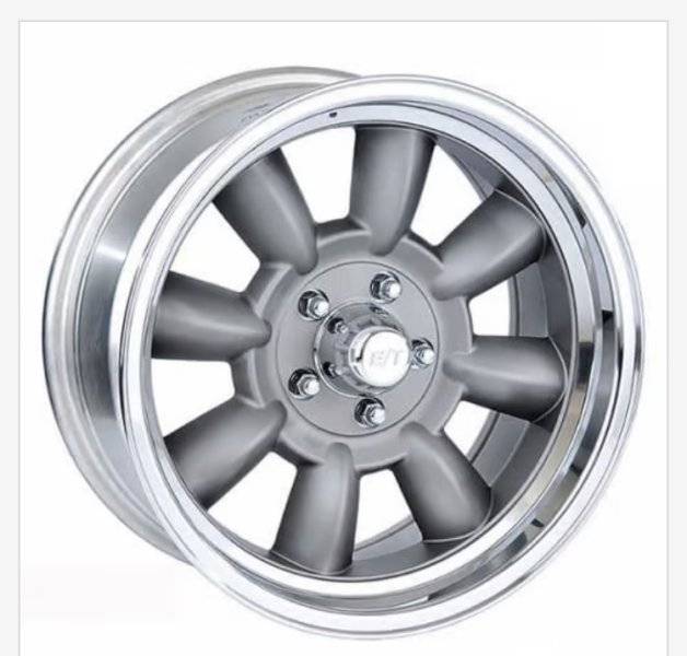

if i need to stick with 18's, i would like to try these, with the grey anthracite color.
I would stay away from any ten inch wheel that doesn't have AT LEAST 5" of backspace. And I like at least 4.5" bs for an 8/8.5 wheel.
Any less is a pickup truck wheel.

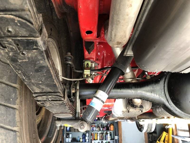

I recently did this and used a similar wheel from Black Rock, the rears are 15x8 with 3.75 bs with 275-50 coopers
And the fronts are 15x8 with 4.00 bs with 235s that will be replaced with either 245 or 255 at some point. Plenty of room front and back
