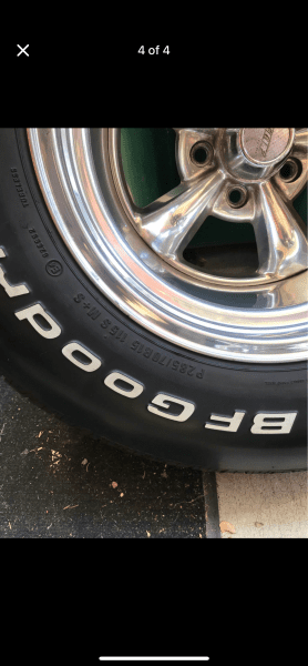

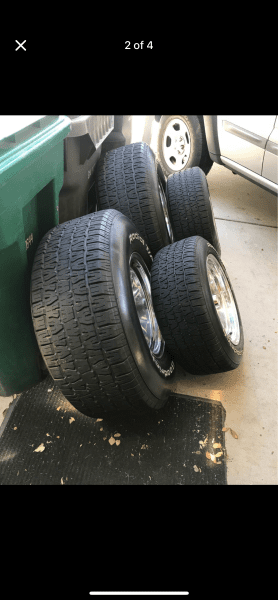

Hi everyone I have a question I’m looking at these wheel and tires the rear ones are a 15”x10” inch wheels the tire size is 285/70/r15 and the rear wheels have a 4”backspace my car is a 1969 dodge coronet will these rear wheels and tires fit?
They'll likely stick out the fenders, and the *** end of the car will have to be jacked up. I would look for a 5-5.5 backspace on a ten inch rim.
OK, thanks for the advice man. I appreciate that.
I think they're about 31" Dia. Which is huge. I think you'd have to get pretty creative..
Yep wrong offset and very tall.
Hijackers for the win!
Using air shocks like when we were kids is your only hope of running that setup on your car.
Sadly Wheelvintiques stopped making the 15x10 cop wheels that paired nicely with 275/70r15 tires that fit under the Coke Bottle Mopars.
