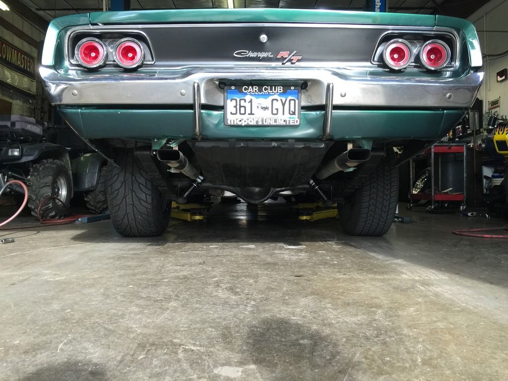

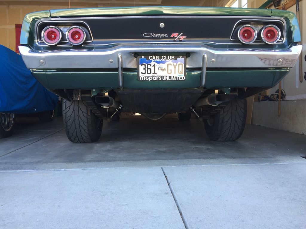

I had 275/60 on 15x8 and just mounted M/T SR 30x12 on Weld Prostar 15x10s. Here is a pic of both rear tires. I picked the SR's because of the size availability and I want them to last more than a few thousand miles like the ET Streets.
30x12 ! Damn ! Stock tubs ? What springs are you running ? What are the dimensions of your wheels?
Nice, I'm running 2 457 S/S springs on mine. I was looking at those tires yesterday, not cheap for sure. The only thing that bothers me about those is they are directional, I wonder how much noise they'll make once a little worn ...

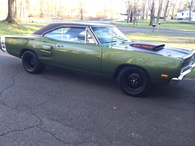

Just went through this and ended up with 15 x 8 with 245s on front and 15 x 10 with 295s out back. Plenty of room and really fills out the wheel wells nicely. I just couldn't get over the 275 60s overall look. They are just too tall and the tires look a bit skinny (for my taste.)

Here you go. I actually have 7" rims up front, not 8.

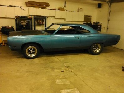

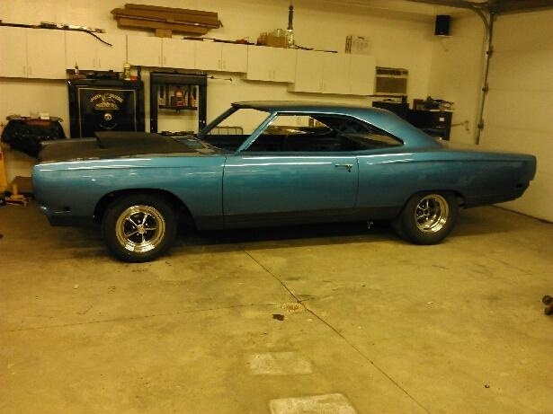

Here is mine with 15x4s up front & 15x10s on rear with 325/50/15s
I used Cal Tracs -1" ride height. I did mini tub it in case I wanted to go bigger down the road. Used the offset front hangers & shackles.
There's more pictures on my thread 69 GTX in members restorations section.
