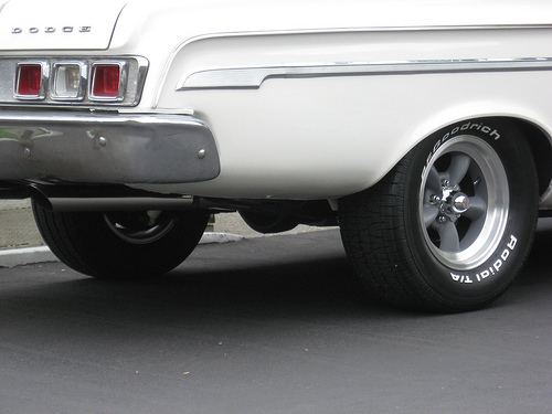

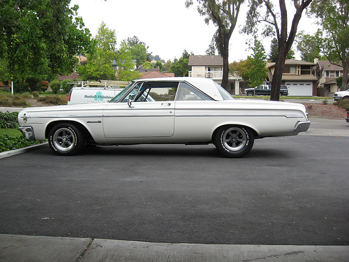

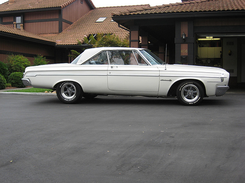

Tried on some 275/60/15's and they fit like a glove. They really look good on the car no rubbing not even close enough to worry about it. I'm really happy with them. Even the guys at that tire shop were stoked.:grin:
Heres some pics

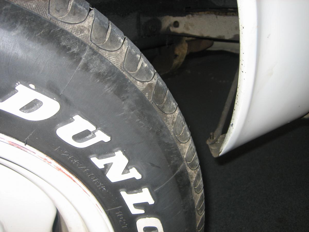

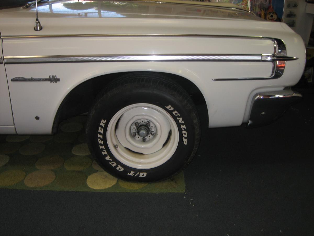

Jeff, are those 225/60/15's in the front?
I have the same car (even the color is the same) with 255/60/15's in the front. I have a problem with the corner of the front tire rubbing the bottom edge of the front wheel opening of the fender while turning and backing.
Do you have this problem with the 225's? If you turn your wheels a bit, how much clearance do you have between the fender and the edge of the tire?
Next question. Do you have the stock strut rods in the car? And... what strut rod bushings are you using?
Thanks again! Nice machine! ~Todd

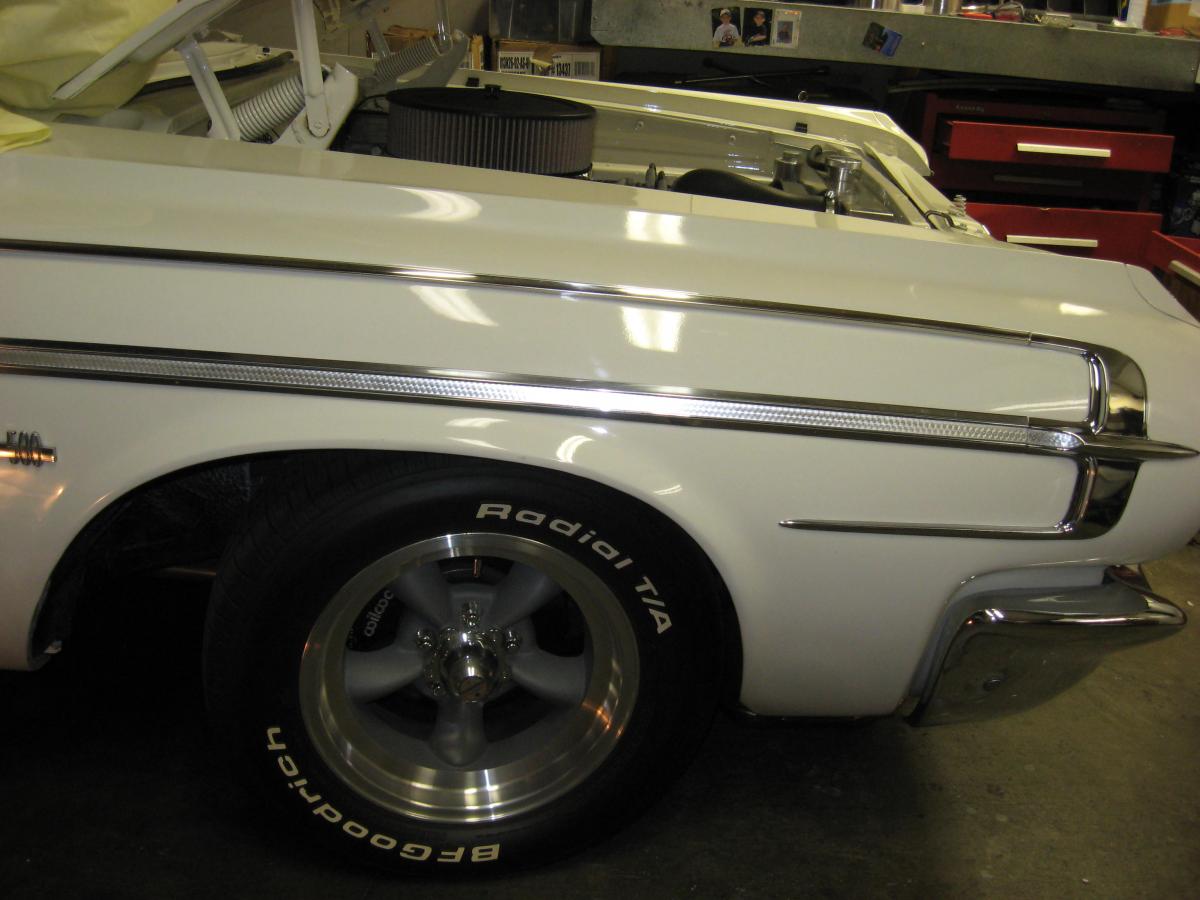

I have 225/60/15 in front no rubbing, If you are talking about the front edge at the bottom of the front wheel opening I have 2 fingers of space.

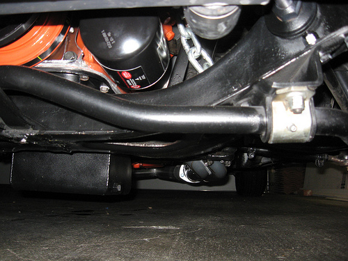

I do have a pretty big sway bar though that somebody put on it before the car was mine, they did a good job.Not sure what size it is but here is a picture. I also have KYB shocks.
I think that combo makes the front end pretty stiff. I dont know much about the
torsion bars I think they are stockers this car was an original 383 4spd car.
I did put new shocks in back and new leaf springs. I really like the look of it with the 275's in back. Post some pics of your car .
Hope this helps you
Jeff

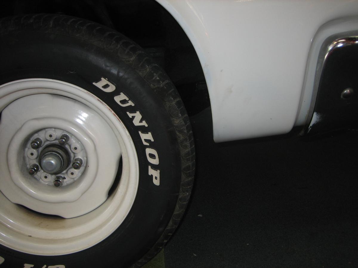

Aside from driveability, my reason for downsizing tires was because I had tire to fender interference when backing with the wheels turned and braking at the same time. I currently have 255's up front.

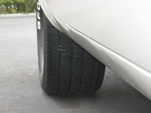

The more I thought about it, the more I didn't want to downsize. I decided to trim a little off the front fenders. I know, I know... bold move. I took an inch off the front inside edge and you can't really even tell. I've got plenty of room now to keep the 255's up front and the 275's in the rear.
