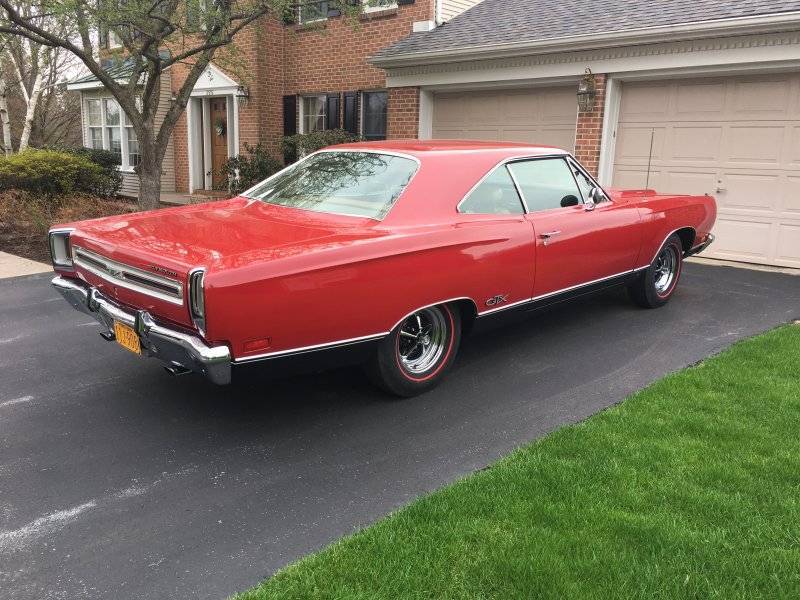

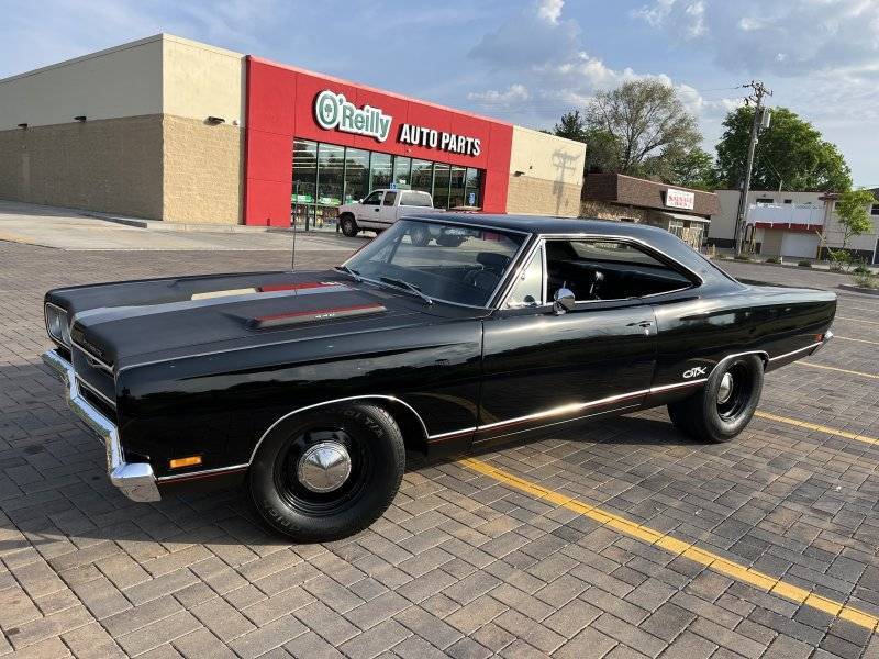

It depends. Case in point - I've posted this point/counterpoint before, my former factory bare bones 4 speed GTX, former street racer, I went with 15 inch wheels, 60 series radials, which I felt were consistent with the car's as built function. My factory A/C, power window upscale luxury GTX, I went with 14s, and red line bias ply tires. Cars had different personalities, I had different motivations. Mr. Hyde, the street brawler, on left. Dr. Jekyll, the gentleman's hot rod, on right.
It depends. Case in point - I've posted this point/counterpoint before, my former factory bare bones 4 speed GTX, former street racer, I went with 15 inch wheels, 60 series radials, I felt were consistent with the car's as built function. My factory A/C, power window upscale luxury GTX, I went with 14s, and red line bias ply tires. Cars had different personalities, I had different motivations. Mr. Hyde, the street brawler, on left. Dr. Jekyll, the gentleman's hot rod, on right.
View attachment 1470713View attachment 1470714

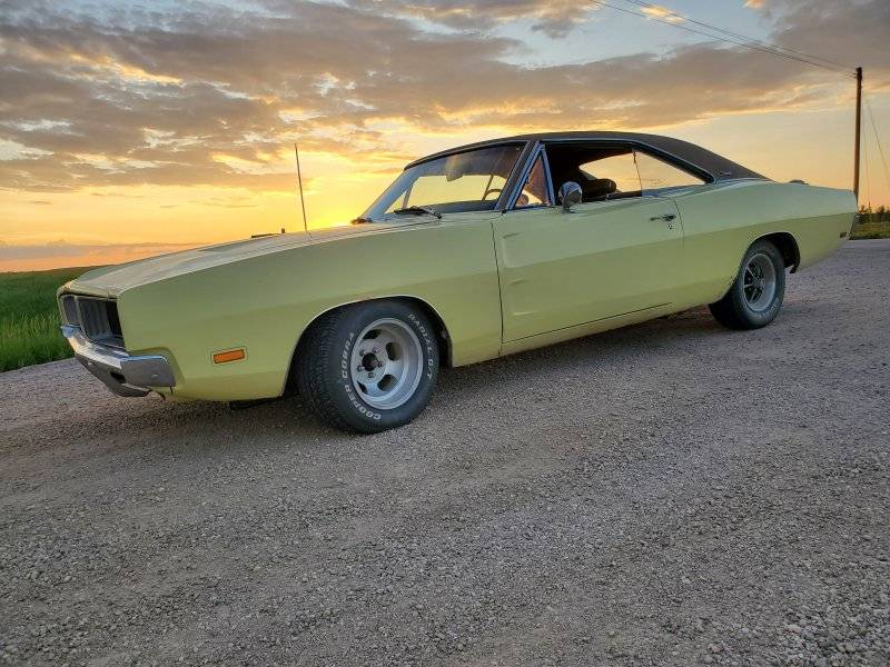

That's the advantage of the open wheelwell of a gen 2 charger. I have those same ramcharger wheels for my car, there is no way I could get that much tire on them under my car. Biggest I can use is 255s.

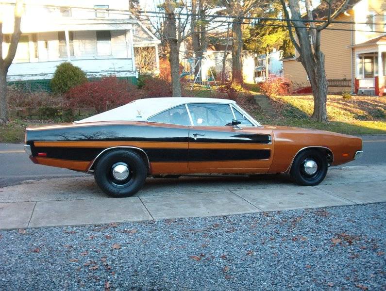

I am interested in your wheel/tire set up with the 14", mag wheels, I assume. I understand that you have had 14"? Which tires and sizes ?
Can you post some pictures with the 14" mag wheels on?
P235-70-14
The 14’s are stock. 215/75 in front and 235/70 in back. No mags, just OEM steels with Mopar hubcaps. I also plan to convert the front drums to disc once the snow flies this winter so wanted a little bigger wheel to accommodate the discs/calipers.
