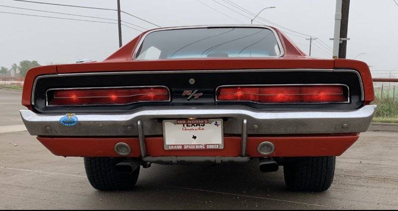

Thanks, I’m looking for a little more in the well, the current stock 14’s are lost in there especially with the tires that are on them. I want the functionality (handling, safe for the rim size, no rubbing in turns/bumps etc, stability) but a little more “fill” than what it is now

Pretty much what I’m looking for, good safe handling and better fill in the wells.

I just want a good handling and safe tire that will fill in the well a little bit. The 14s with the tires that are on there seem lost in those wells. So nothing to big nor major, just a little more fill. I got these rims because it’s the style I like and they were 15s, which I felt was what i was looking for, a little bigger but nothing drastic. I drive it for fun and to local car shows, not drag strips. It’s pretty much a survivor so didn‘t want to change it to much. I’ll look at the web site again, but honestly I wasn’t sure how to utilize it (very uneducated in tires and sizing). Thanks for the advice!
