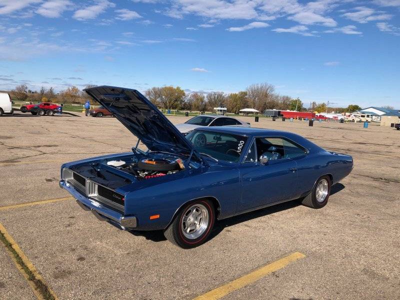

It has the rms rack & pinion frt with ride tec single adjustable frt shocks (which were turned all the way down), it has the comp engineering rear shock but not sure if the setting is right as they are a pain to adjust.

I bought the pricy ($400/each) Viking triple adjustable shocks for the Charger right before Bandimere closed and haven't had a chance to try them / adjust them at the track.
I run the M/T ET Street tires, 4.10:1 Strange S60 with spool, but my suspension is nearly stock, pinion snubber and an extra leaf in the rear spring pack.
With the old cheap KYB shocks, after leaving the light, I had to back off and roll into the throttle. I think my 60' was 1.9's with mid 11's at 120 MPH (at Bandimere)
I was going to change out my 0.960" MP T-bars with factory 318 T-Bars and with the new adjustable shocks try to get my 60' back to at least the 1.7's or better.

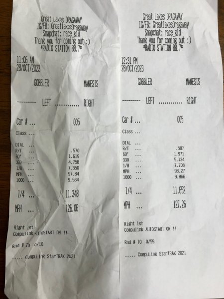

I got a 1.619 60ft with road race tires, manual trans, 4.56 gears and ss springs.

That's.an impressive 60 ft for a stick shift on road race tires. How quick is the car?

1.61 is very impressive for a street car with a stick, NOT on drag slicks. Well done.
I think it’s the manual tranny. They seem to be up 2-3 mph over an auto counterpart for the same et. Mopar used to bake that into their drag strip dyno calcs a too.
He’s up almost 30 mph from his 1/8 mph. 23 mph is a more typical number. It’s running hard on the big end.
