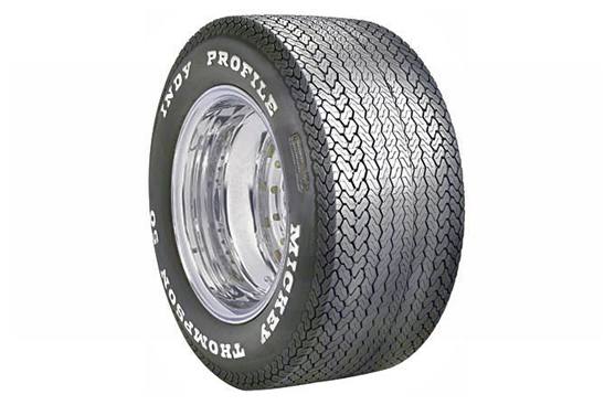

I have the factory chrome plated steel road wheel and I'd like to keep it that way. The tires on there now is 215/75R14 I was wondering if these Mickey Thompson Tires would work:
M/T1036 L60-14
Tire Size: 295/60-14
Wheel Diameter: 14 in.
Tire Diameter: 28.00 in.
Section Width: 12.30 in.
Tread Width: 9.50 in.
Minimum Recommended Wheel Width: 7.00 in.
Maximum Recommended Wheel Width: 10.00 in.
Is the 15mm difference in tire diameter going to hurt anything besides my speedometer that doesn't work? And will this tires fit without any modifications on my 1967 Charger?

Those M/T are too wide for the factory Road wheels.
You will need at least an 8 inch wide rim with a 4.5" backspacing to fit it.
Your factory wheels are only 5.5 or 6 inches wide.
You can get a widened wheel to match to fit them--plus as mentioned you cannot mix bias with radial.So go with a matching smaller M/T up front.
Or go with a BFG radial T/A in a 2456014.
Another suggestion is upgrade to 15 inch wheels to expand your options and more readily available rims and tires since most 14 inch are going away with the do-do bird.

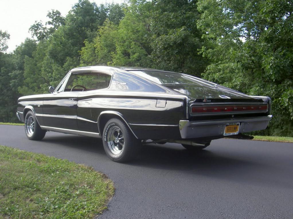

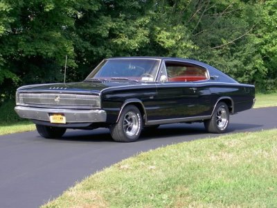

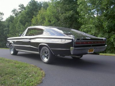

All I want is a wide tire for the rear because I hate the gap of the wheel well. What size tire are you running on you '66?
I am running 245/60-14 on mine all around.
