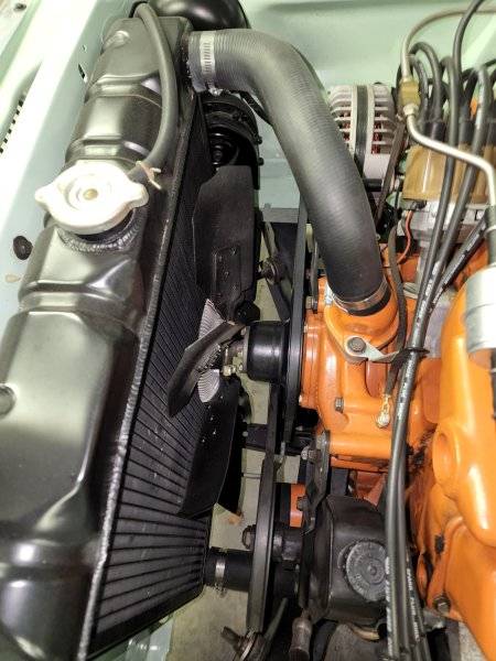

I'm putting an aluminum radiator in my 62 Dart in place of a 1969 Mopar rad that's falling apart. I have a shroud that was on the '69 radiator and was wondering if it's really needed at this point. I've seen other vehicles without one, but obviously I don't know how the car is driven. I live in NC where the summers are HOT and humid. The fan is an aftermarket belt driven fan. The motor a mild 413. Would it be ok to not use a shroud?

No. You need a shroud. There is no good reason not to run one.
Ideally you want one third of the fan out of the shroud. Doesn't matter about the distance, fan to radiator, as long as it's not too close, one inch maximum. One inch clearance from the end of the fan blades to the shroud opening seems to work.
I agree. Use the shroud. It will make a difference. And you already have it!

It is always best to use a shroud. The shroud needs to be sized to fit the fan.......
You say you have an aftermarket fan.......if the OD is smaller than the shroud is designed for, the benefit of the shroud [ considerable ] is reduced...or lost altogether.
Make sure you seal the gaps around the new rad.....& also the gaps between the shroud & the rad. You want to make sure that ALL the air is drawn through the rad.....not around it.

In my hunt to lower engine temp I found an OEM shroud my car had as a fleet package/AC. I installed this. Went from a 4-blade to 7 fan. Did several other things though, getting the desired result before opting for a larger radiator. Got a bit concerned about after-market shrouds reading some stories about messing up air flow going from bad to worse; though some of this has to do with fan position as posted. Reading some other posts might try going back to the 4-blade fan as the 7 is a lot heavier than the 4.

I found an aluminum 2 hole shroud and it’s made a big difference. I have the fans set to turn on at 170 and it holds 170 steady now.
How have you secured a shroud on an aluminum radiator? I have a Champion 21".
