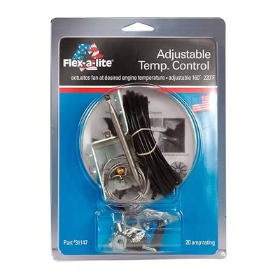

Just get one of these babies and forget about it.
http://www.summitracing.com/parts/flx-31147/overview/
yeah.i already got all the stuff to make it myself.ill let u know how it turns out
