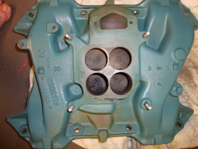

2) anybody have a relatively easy way to clean out all the carbon deposits in the intake without media blasting? She was pig rich for two years while i drove her..:black_eye:

#2 I always let them sit in a parts cleaner for a day or two then hose them out with water. I guess you could try any grease cutter then pressure wash it out. A couple of cans of carb. cleaner would take out the worst of the build up...

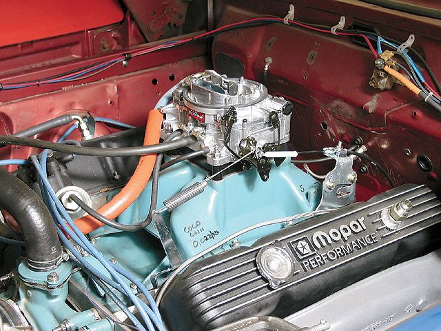

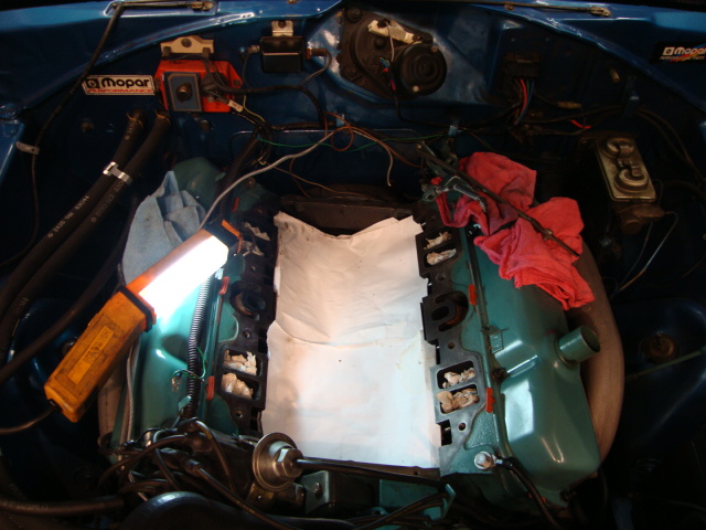

Here's a couple of pics...not the most glamours i've put up to date, but at least it has a MoPar in it!!! :rolling::rolling:

I have simple green in house, i may try that first and blow dry it with air...see how it turns out. I'm thinkin goin from top to bottom to wash it out.

Oh yeah, BTW, where is the left hose on your carb going to? mines just plugged??

#1....I have a holley so mine are on the side.But you can just cap the far rite one it's full manifold vac.You want the left vac port it's the timed vac port.
#2 Carb cleaner and a tooth brush.

Anyway, intake back on and clean(er), and ultra black curing...
Taking the carb apart and cleaning it now.
Test and tune sunday!!! :banana::jiggy:

I misspoke - the ported vacuum on the AFB (alum four barrel) is on the choke side of the carb. Ported means you won't have vacuum at idle (or shouldn't) but will just as you open the throttle.
Castrol super clean or the purple soap at home depot should do a good job on the intake. Just don't let that soap sit on aluminum parts too long or it will turn black.
