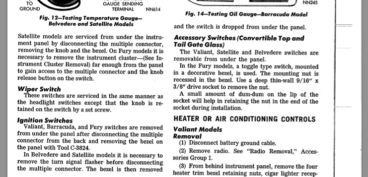

Would someone know where I could by a tool for removing the the light and the wiper switch? 1966 Satellite -Rich
Maybe useful?
Damned auto-resize! Full readable image is here:
http://i562.photobucket.com/albums/ss70/dreljay/ScreenShot2012-10-15at72352PM.png
I got the knob off...I need some type of tool with a couple of prongs or something to turn the nut off to remove the switch
Left handed spammer winch? :D I've used snap ring pliers before or a screwdriver. It's usually not that tight and either will work unless things have been sitting outside.....

Nice guy, very nice specialty sockets at fair prices. Using tools like this instead of screw drivers is a good idea and will help preserve the details of the interior of your classic mopar.
I've carefully used a pair of needle nose pliers as a spanner wrench to remove the securing nut.
Go to your local CVS or other drug store and buy a spanner wrench for removing watch backs. A couple of dollars and works great.
