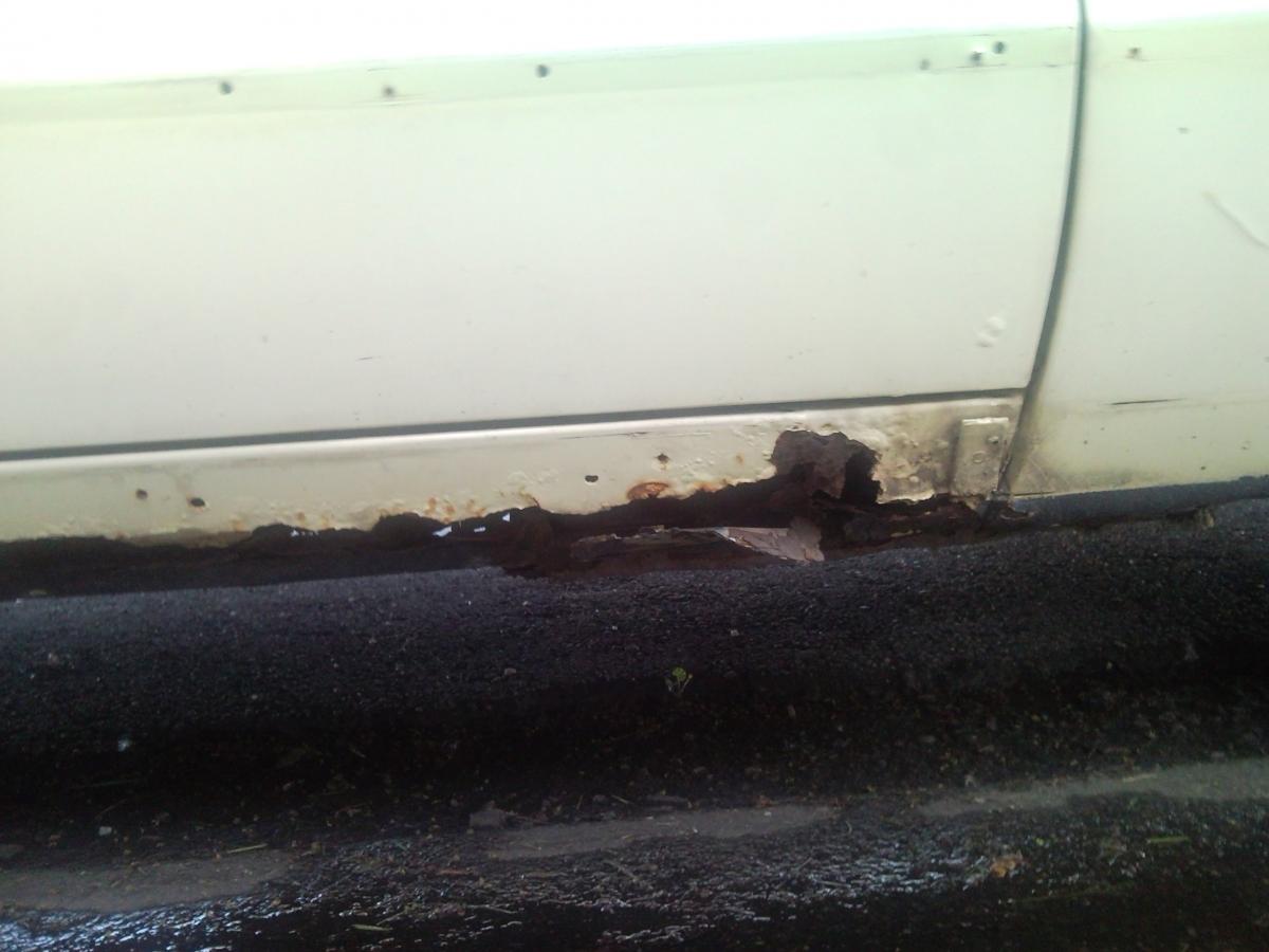

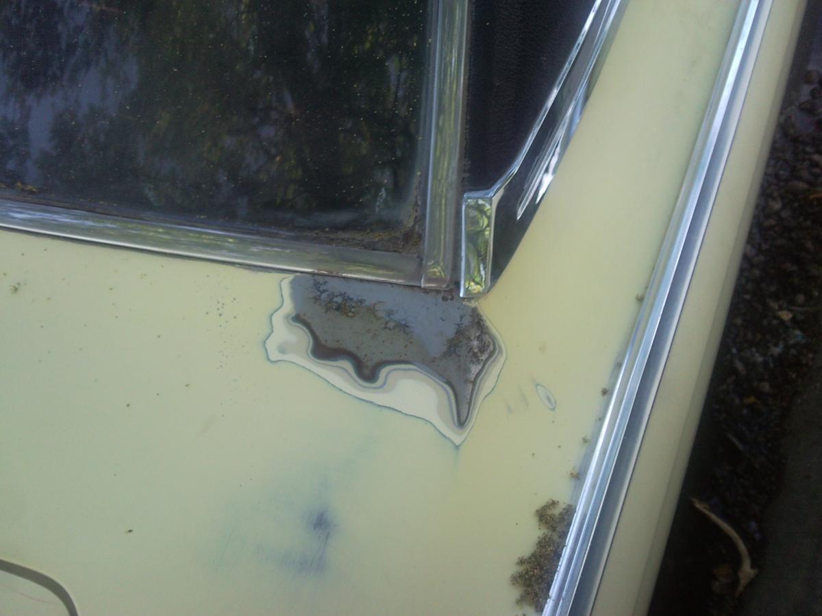

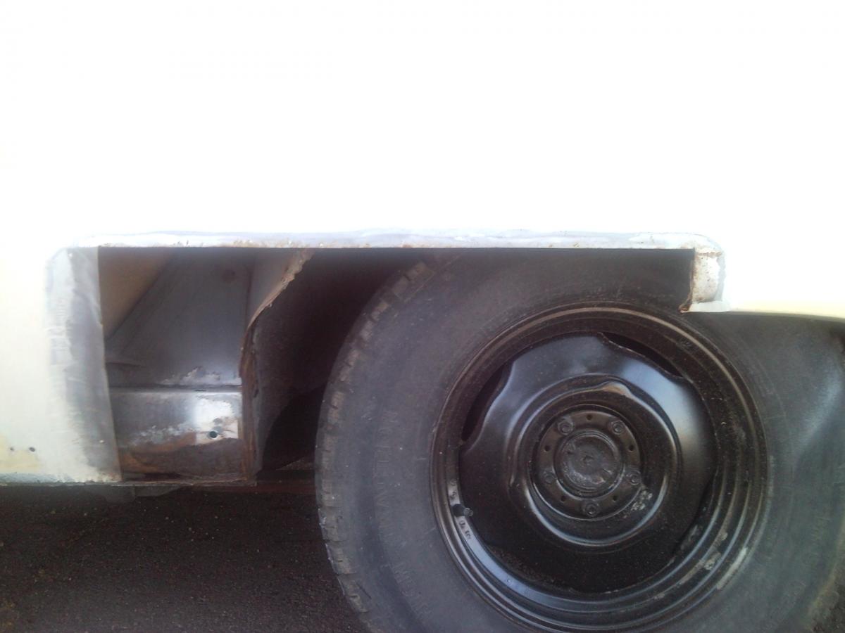

:eusa_dance:Ok she is running good and I mean damn good it all came down to the plugs and the timing and the wife took it out for a drive she came back smiling from ear to ear and wanted to know if we could take it to church today LOL. I knew she would like it once she drove it. She has never driven a V8 car let alone a BB mopar. It is a little sluggish on the bottom end though thanks to the torker 383 manifold. Oh yeah the edelcrap carb is long gone first thing to go. Now just got to get started on the body work ie. lower quarter patch panels on both sides and an outer rocker on the passenger side everything else is just surface rust.:headbang:
