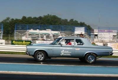

I did my 451 in 2000.Ran it with a Torker 383,750 AFB,3500 converter,4.10 gears,27'' slicks.3625LBS with me in it.Complete street trim and using Schumacher 1 5/8 TRI-Y shorty headers. 11.90's all day long.
