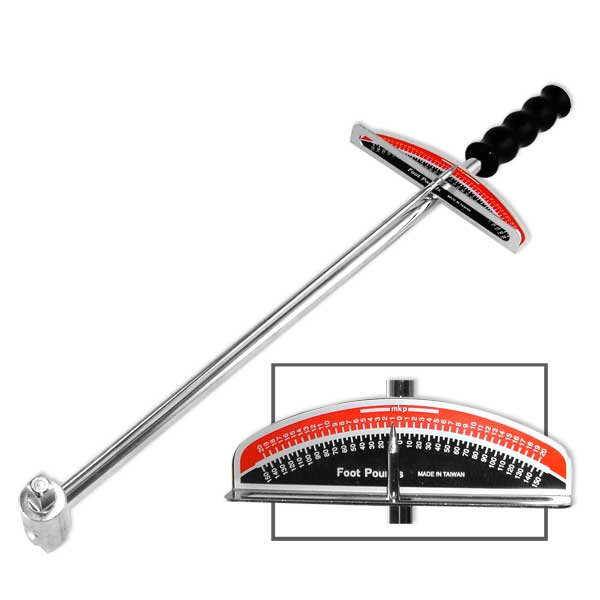

I only could torque one side ....Had left /right hand threads.....Torque wrench only goes one way.....
Mines the same, didn't think about that! rightie loosie leftie tightie (left side!) Thanks for the reminder!
You guys need this ratchet that goes on breaker bars and torque wrenches. I use mine all the time because it ratchets both ways.
