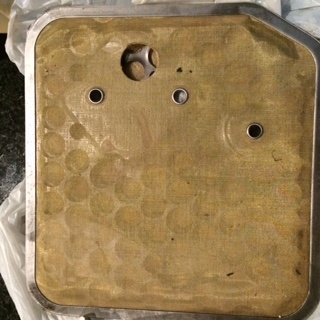

If this helps, here is a picture of the filter that came out of my 727 when I put on a similar B&M. The new filter looked like the old one with the one hole. I made sure the extension lined up properly and there were gaskets on both sides. This might not apply as it is a later 727 than yours.
Yes. And I believe that is what hangout is suggesting.

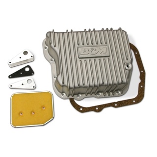

The trans will pick up fluid as the fluid level is above the filter and just about covers the valve body. Dont forget the 3 screws that would hold the filter on.
This is the B&M picture of the kit model number I installed. Looks like the extension has only one suction hole as y'all feared. Cannot believe B&M would not include these type precautions. Hopefully, I will have time to drop pan tomorrow. Hope there's no damage. Thanks for y'all's insights.
