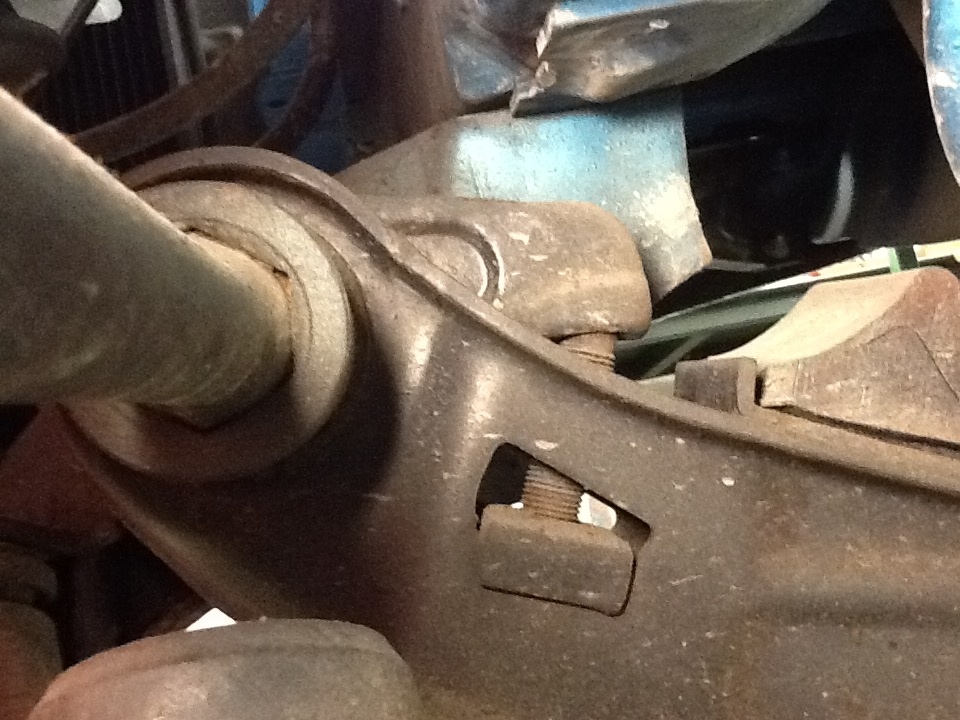

I was under the bee yesterday working on pulling my steering gear and noticed the ends of the torsion key adjusters are rubbing the inside of the frame rails where the clearance notch for them is. Anyone have an idea why? The suspension as far as I can tell has never been rebuilt it's a 69
bee with a 440 installed and also the adjusting bolts seem like they are
run way up. There is about 1/2" to 3/4" thread left exposed. I know some are gonna want pics I will see if I can get some.

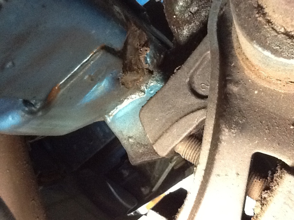

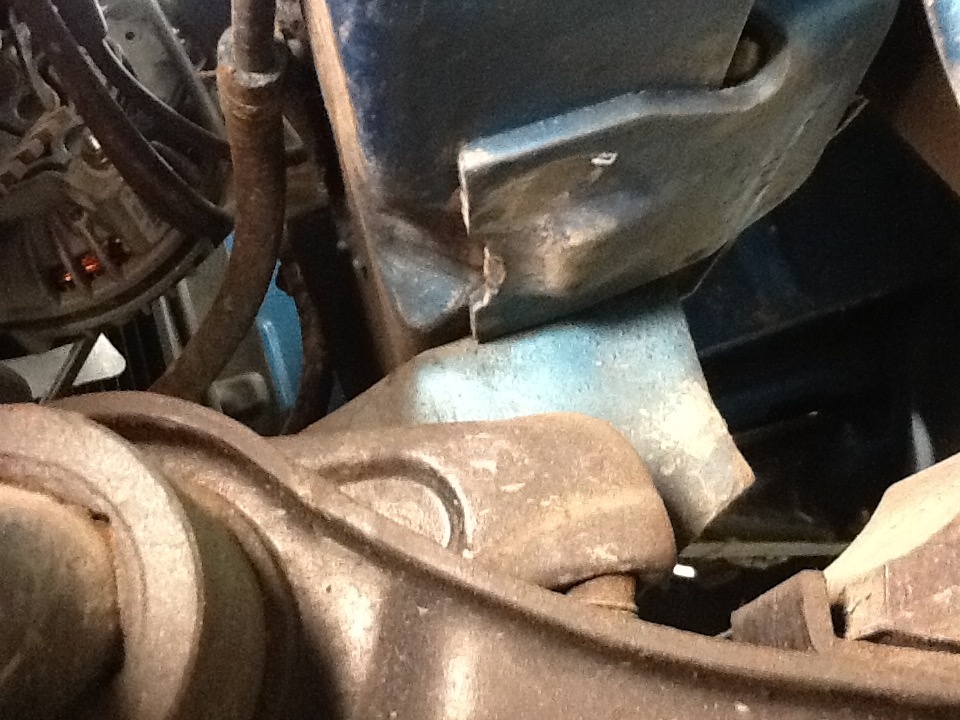

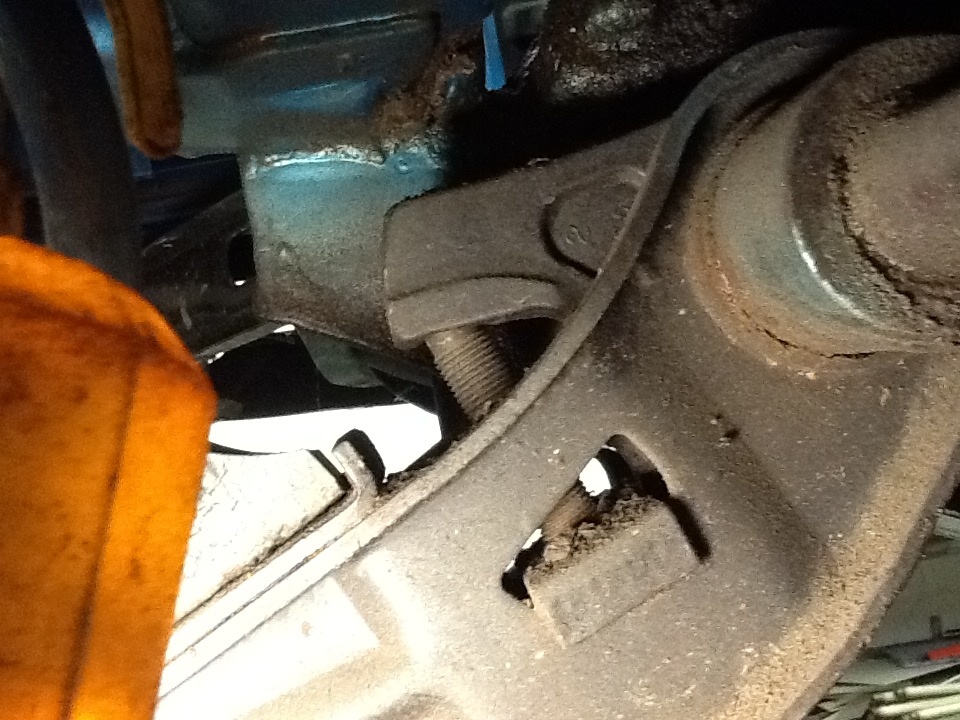

First two are left side and other two are right side. The right side isn't adjusted up as much and isn't rubbing as bad but is still making contact.

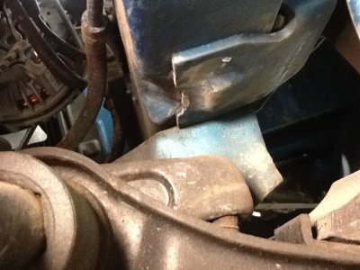

One left side pic didn't upload so here it is
I don't see any rubbing. They look fine to me.
Trust me when I say they are rubbing. The last pic I posted shows it. As stated the right side isn't as bad as
the left but is making contact
The above pics are with the front jacked up with suspension unloaded
Yea the bumpers are there do the hex keys look too high?

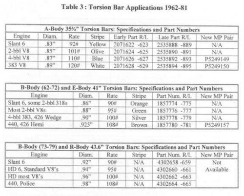

Are you sure they are the original torsion bars and someone didn't substitute some 6 cyl bars to help with weight transfer at the drags? When I pulled the front suspension on my 67 GTX a few months ago, after pulling the rubber travel bumpers and letting the suspension droop, from memory I don't even think my adjusters were still in contact with the a-arm lever. If I'm wrong and they were it didn't take much to back them off.
They could be slant bars I will measure them. What dia. are slant six bars?
