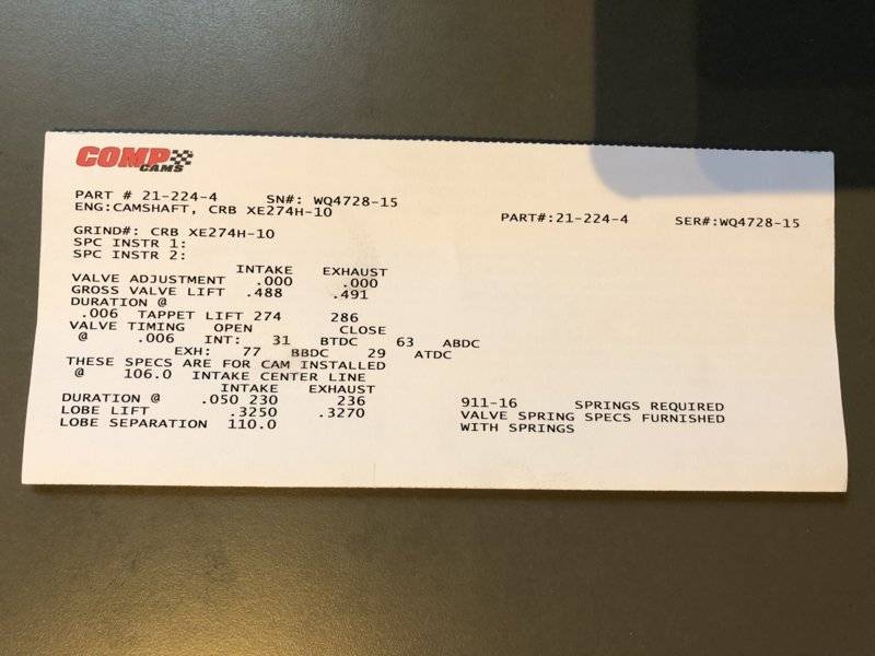

I think 3,000 to 3,500 for all-in is about right for your wagon. 20* initial is a lot. What octane fuel? What are the cam specs? What rear axle ratio?
Mike
I put 100 Oktane or 102 octane all the time . But now it works without pinging also with 98 octane, but my timming like what I say , too late full in . Maybe if I correct my timing it will be pinging again , or and I need again the 102 octane to make it better.
Rear axle has a : 3:53 Ratio
Cam: CCA-CL21-224-4 XE274H-10
Intake : dual plane Indy

Wow 200psi? I use that same cam at closer to 9.5-1 and cranking compression tested 150-160, but with 84cc aluminum heads. Which heads are you running? My setup likes 20° initial and gets to 38° by 3000rpm or just over. No pinging on California 91 which has a little ethanol in it(68 satellite/440/3.73/auto trans)
I feel your total should be in sooner for sure. You'll have to just keep trying different things as no two engines respond the the same..
