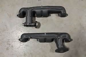

The left picture shows the magnum manifolds, the standard 325 hp log style is on the right. 325 4 bbl was premium fuel for 1966, sort of a low point as earlier and later versions had more power - you could get a dual quad 343 hp. version in 1962, and the road runner and magnum version from '68-70 was 335 hp.
