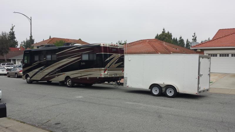

I have a 16' enclosed trailer that weights about 2k #'s I'd like to pull with a 73 Satellite wagon. Naturally I want to set the car up to do so, bigger radiator, trans cooler, 8 3/4 or 9 1/4 rear with lower gears, 3:55 or 3:91. Police T-bars and leaf springs. Maybe air shocks too? Upgrade the front to 11.75 brakes.
I can get a class 2 or possibly class 3 receiver made.. With 2 dirt bikes and camping gear, should be under 3k. What I can't find is rated towing capacity for the car. Is it doable? Is it even safe? Perhaps I should be patient until I get a truck next year?
