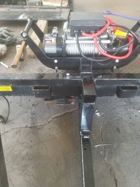

I have the 12,000 lbs. winch from Harbor Freight on my 1999 18' Road Warrior brand trailer. I bought the winch, winch receiver mount and the receiver socket from Harbor Freight. I have had a Northern Tool brand tool box on the trailer since new. I removed the tool box and welded a receiver socket into the frame so I could remove the winch by pulling the receiver pin when have the side racks mounted. I notched out the tool box back and bottom to clear the receiver socket and remounted and sealed. I have the battery for the winch, winch controller and break away box mounted in the tool box. The power cables have quick disconnects inside the tool box
for easy removal. Works great the handles on the winch mount make removal easy.

I have the same thing, 12,000 lb HF winch mounted on a receiver. The first mount I bought was too flimsy and twisted, the second one I bought looks just like yours (think I got it from Northern Tool?). It's held up extremely well, and I've pulled so much weight the circuit breaker would trip. Used it to pull down a Black Walnut tree that fell into another tree. Also used it to drag an upright Reach style forklift on it's side up the ramps and on my trailer.
The winch is a lot of weight to carry around though, especially for somebody with back problems.
I also have a Horror Freight 12,000 lb winch in my enclosed trailer that will drag in a project car on 4 flat tires and even with seized brakes if needed. With one of their -20% off coupons it was only about $250 back when I purchased it about a dozen years ago now.
When I first got the trailer in 1999 I had put the winch inside the tool box. I found the way I had it mounted was too low and the cable dragged across the deck and pulled the nose of vehicle down. With the receiver mount higher is lifts a little as thing come up the ramps. The handles on the winch mount make removing/installing easy.

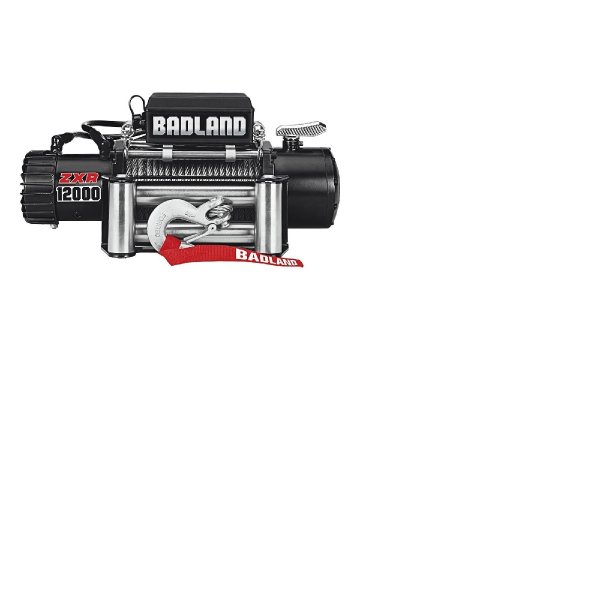

I did get the 12,000 lb unit yesterday. A buddy sent me a text that Harbor Freight had a ONE DAY sale of 40% off!
I got the last 12,000 one they had, it has the steel cable. This box in the picture was a display model that wasn't for sale.

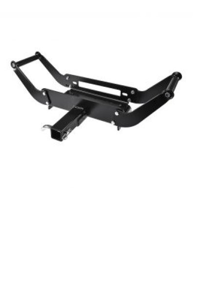

I have a few ideas on how to mount it but I may just order this setup:
I want to be able to not only stow this out of sight when not in use but also attach it to other vehicles if/when needed.
