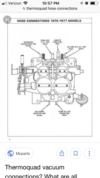

Thanks. My Thermoquad only has manifold vacuum. I’m trying to find out what is the initial timing before plugging in the vacuum advance. I realize every engine is different, just trying to find a good starting point.
Just hook a vac gauge to that nipple, at idle then up the rpms. Mabey someone who knows more about the Tquad carbs will post.
But the gauge will tell you pretty fast, or heck just start it and at idle pull the cap and see if the idle drops like it has a leak.
Dr side front nipple right of the idle mix screw is where you hook up the va to the dist.
