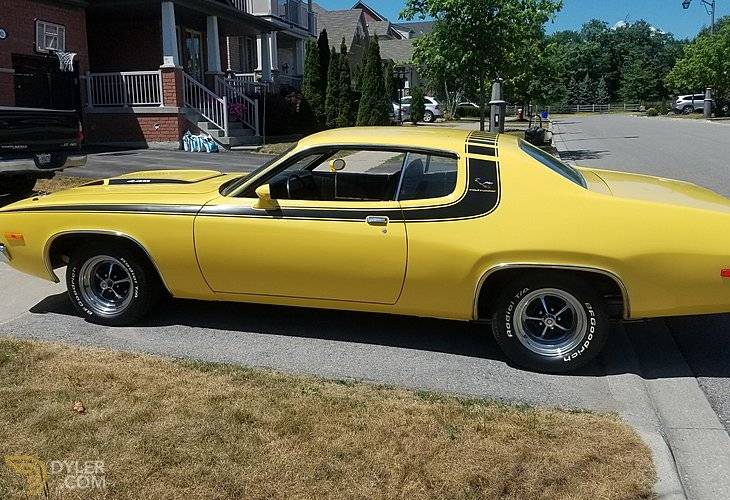

1973 Roadrunner with peg leg for a rear end. Original owner had a set of yellow traction bars on it. I know they really don't do much with a mopar rear setup but I am thinking about looks only. Thought they always looked kinda cool. What do you think?

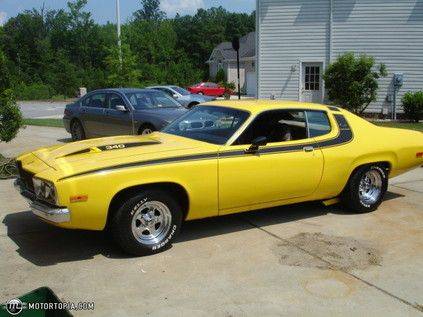

Or this

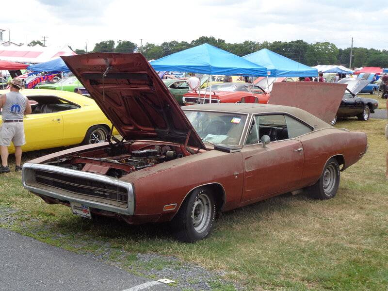

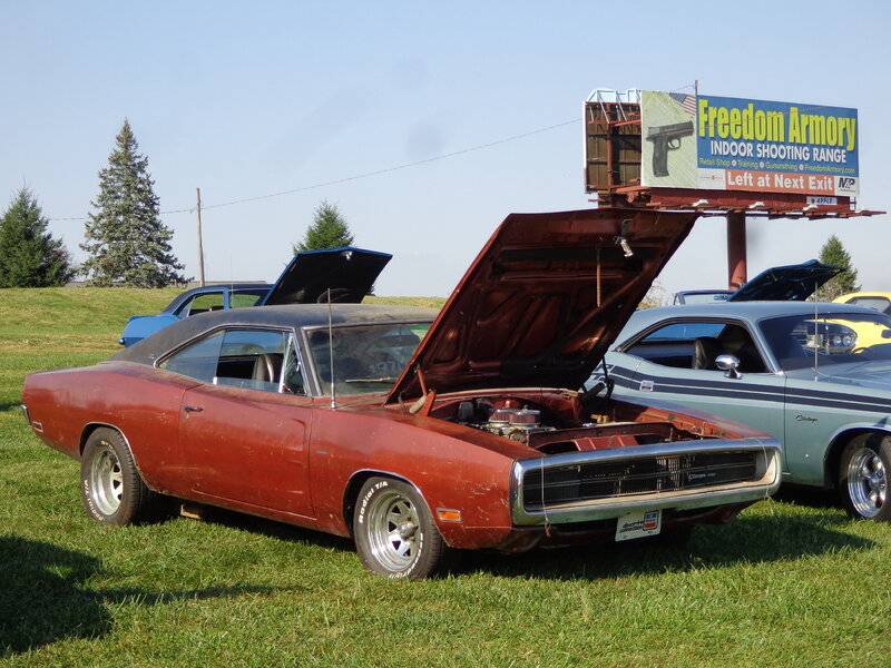

3:91 rear gears with a Sure Grip, Firestone L60x15's on the rear, Super Stock springs, 40/60-50/50-60/40 front shocks, yellow Lakewood Traction bars with the rubber snubber up against the spring eye, solid steel motor mounts and a Winter's built A727 transmission and a flexible solid shaft shifter contraption. Well if Mopars never intended to have traction bars on them, Lakewood should have had printed in the product's description, "WARNING NOT TO BE USED ON MOPARS".:luvplace:
Photo taken on 9/23/16
Photo taken on 7/11/20 at Carlisle.
