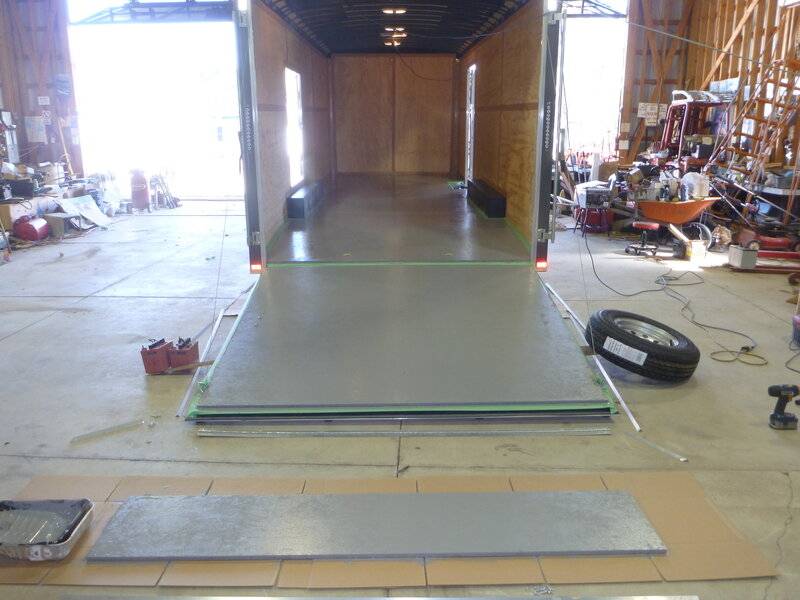

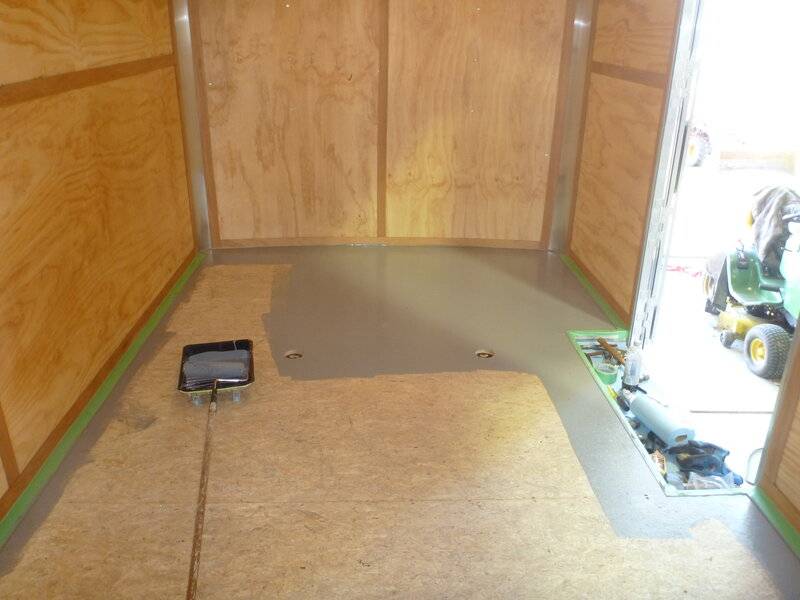

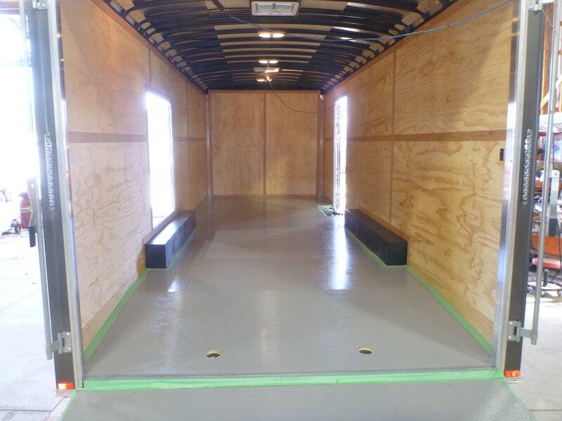

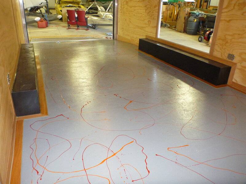

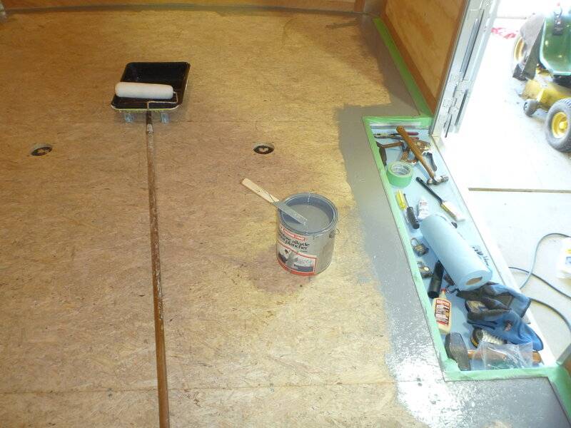

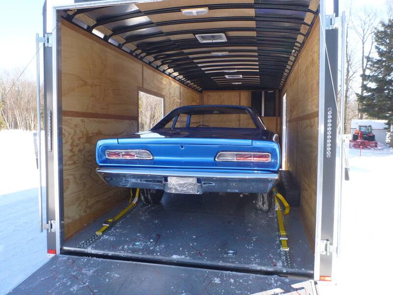

Good old floor/porch paint.. and I mean old Alkyd if you can still get it down there as we can't. I found a 25 year old gallon at the back of one of my shop shelves to use... and a bit of dribbled enamel to break up the gray and help hide scratches and the likes. I also put some gloss varathane on the walls.
View attachment 1087329 View attachment 1087330 View attachment 1087331 View attachment 1087332 View attachment 1087333

I did porch and deck paint too like @dadsbee
Looks like it worked okay, no anti-skid needed. I tried to figure out what to do and it all comes down to $$$. Figure out what your willing to spend. Y
I didn’t like the epoxy idea, I can’t understand how it would flex with the wood. The paint is a thinner coating and can be touched up from time time very easily.

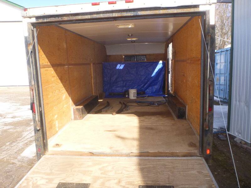

I will add, the floor is a tad too slippery, especially the ramp if coming in with wet or snow covered tires.. I need to mist some clear and throw a bit of grit on at least the ramp.

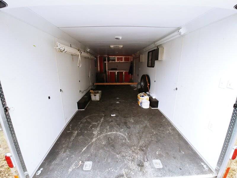

My trailer has what they call "rubber coin" flooring, basically a textured vinyl flooring that's rolled out and glued down.
I like it. It's filthy in the pic, but I not only roll cars in it, but also (mainly) my concert production gear. Small casters, hand trucks, non-wheeled boxes, speakers, amp racks, and cable bins. No rips or tears, and good traction when wet. I do need to do something about the ramp door though - stainless diamondplate SUCKS when its wet!!

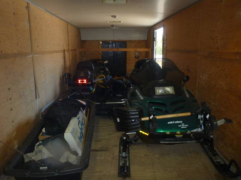

Not quite the same but I use 1/4"cheap plywood as a sacrificial floor in my snowmobile trailers over the marine plywood they come equipped with. You could do that and coat it with anything. I add oak cleats to the ramps for walking safely. The coin pattern floor sounds good to me.

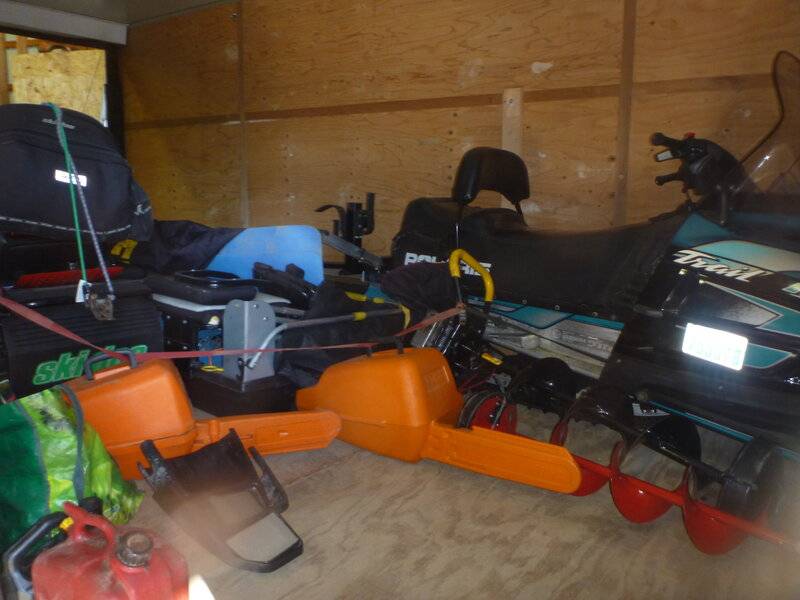

All that said, this trailer has been beat to hell. 20 years old, I use it for sleds, portable blasting, etc and while the entire trailer has pretty much rotted around it, the plywood floor is still mint. Even with running sled carbides across it every winter.

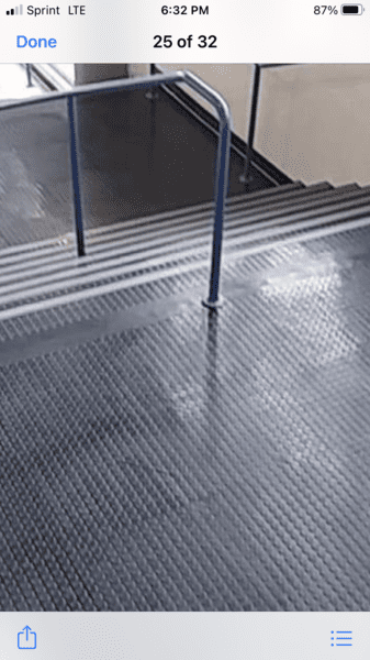

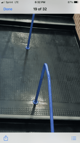

Roppe raised rubber tile for stairwells. I use them on stairwell landings all the time. Installed some in a friend’s trailer several years ago and they held up well and still look nice.
