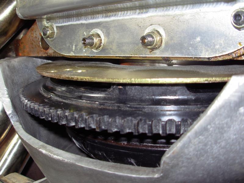

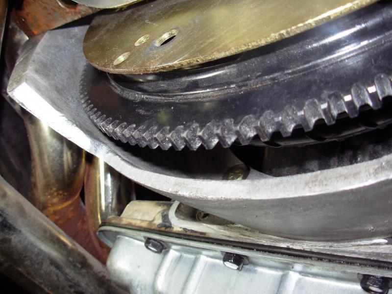

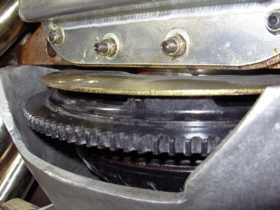

I'm hoping you didn't put the flex plate on backwards.Here are some pics with everything installed.Once you slide the converter ahead and bolt it there is alot of clearance.You can see it in the pics.The snout on the factory starter can be a problem.You can see the clearance in the first pic.

A couple things I notice..... Your converter sets no where near the pump housing / mounting bolts. Mine will touch the mounting bolts because it is a larger dia. and I'm sure it's thicker from mounting tabs to the opposite side of the shell. Also, as mentioned in an earlier post,,,, it does appear as if your mounting flange holes are counter sunk more than mine...??? I'm guesing the starter nose is different between the Nippon Denso and the chrysler starter. When I worked at an autoparts store through college, I discovered that a Toyota starter was thesame mounting and correct dimensions to use on a Mopar.... Later on I seen these "Mini" starters for Mopar being sold,,,,, it was the same starter but cost more!
