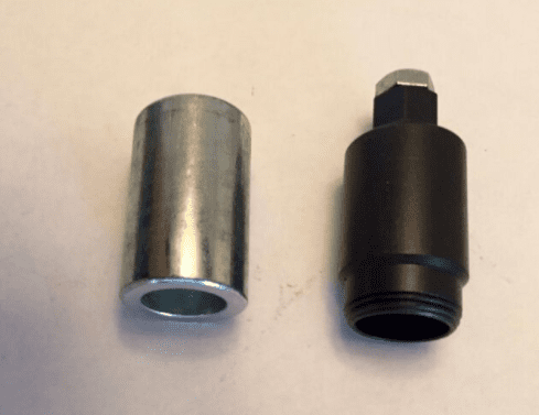

This is the tool needed to replace it. Or drop the valve body.

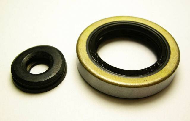

Selector shaft seal.
Edit; there is also a small seal for the throttle valve shaft.
But, Its normally the larger selector shaft seal that leaks.

It isn't a difficult job to do in the car. You need to drain the fluid, drop the pan, drop the valve body and then drive the old seal out and pop a new one in there. An experienced guy with a lift can probably do it in an hour. If you don't have the tools to do it yourself then look around town for an old time type of transmission shop. Not a chain shop where they will charge you a bunch and never fix it right. You need to find an older guy who knows what he is doing and does the job right. He'll be able to fix it the same day and will probably charge you less than $100.
