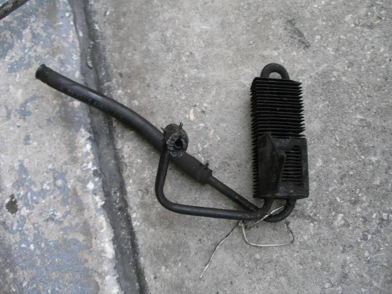

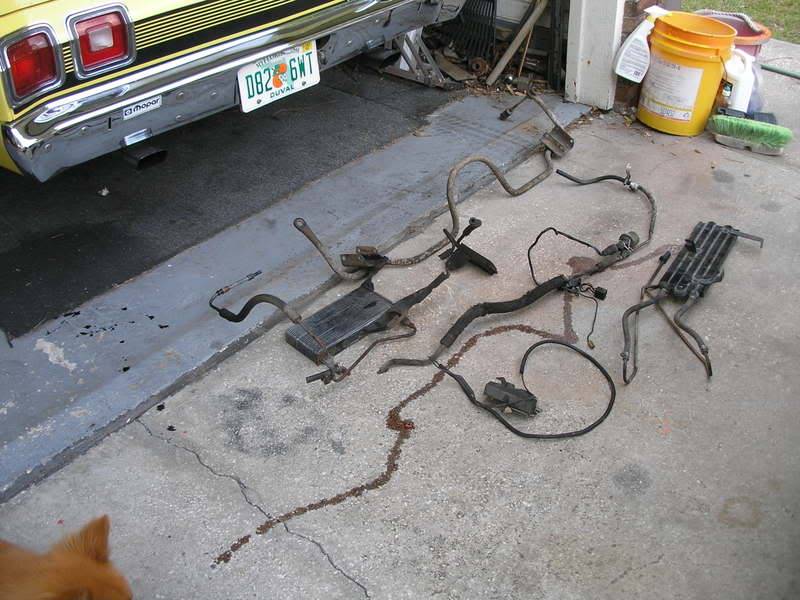

Use stock style tubing and bend it to fit with a good tubing bender.
Route the fluid thru the radiator cooler and then thru the aux. cooler then to the return line to the tranny..just like the factory did on police cars.
I got this whole set-up from a Diplomat cop car.
Oil Cooler, tranny fluid cooler and power steering fluid cooler.

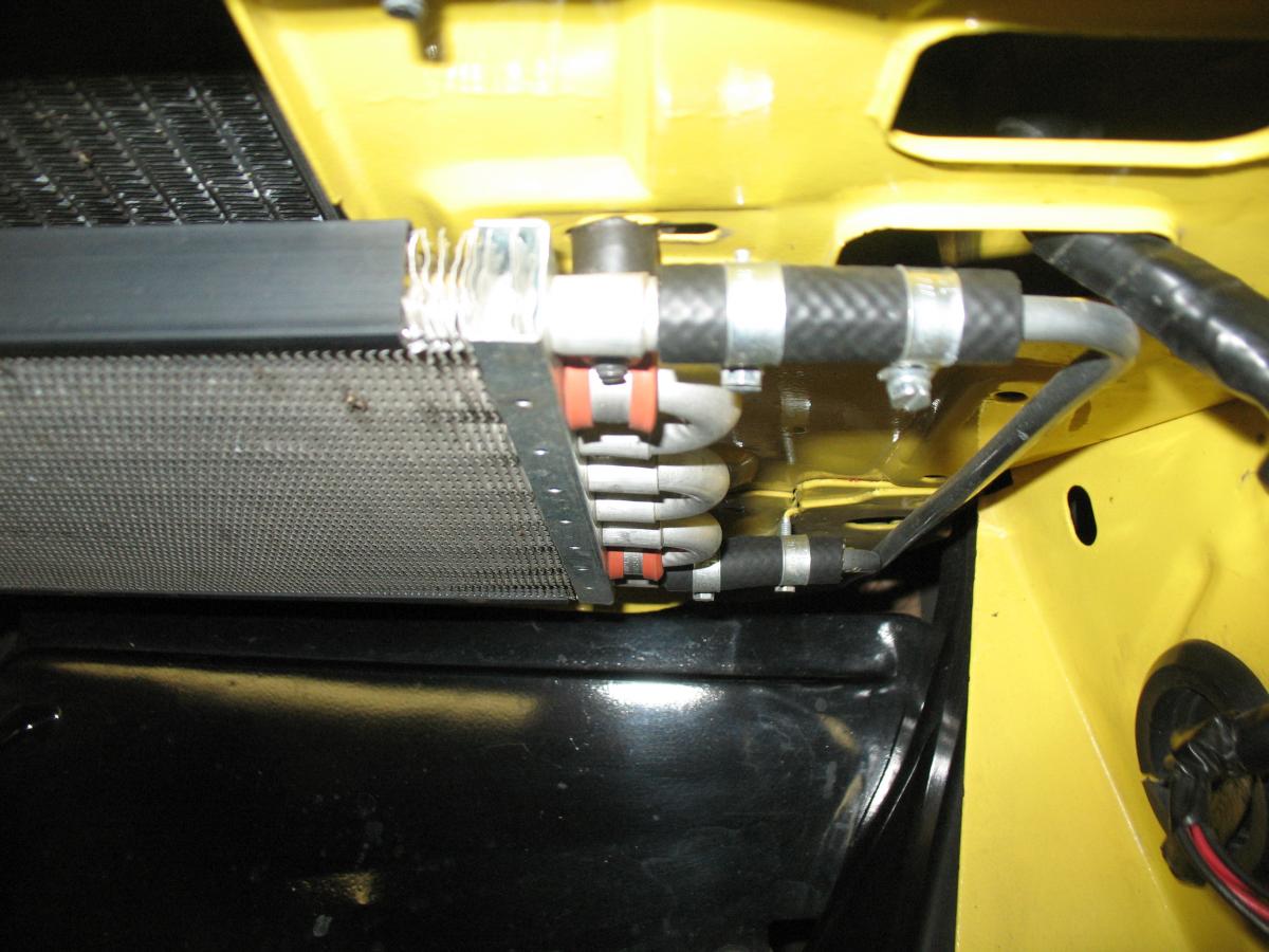

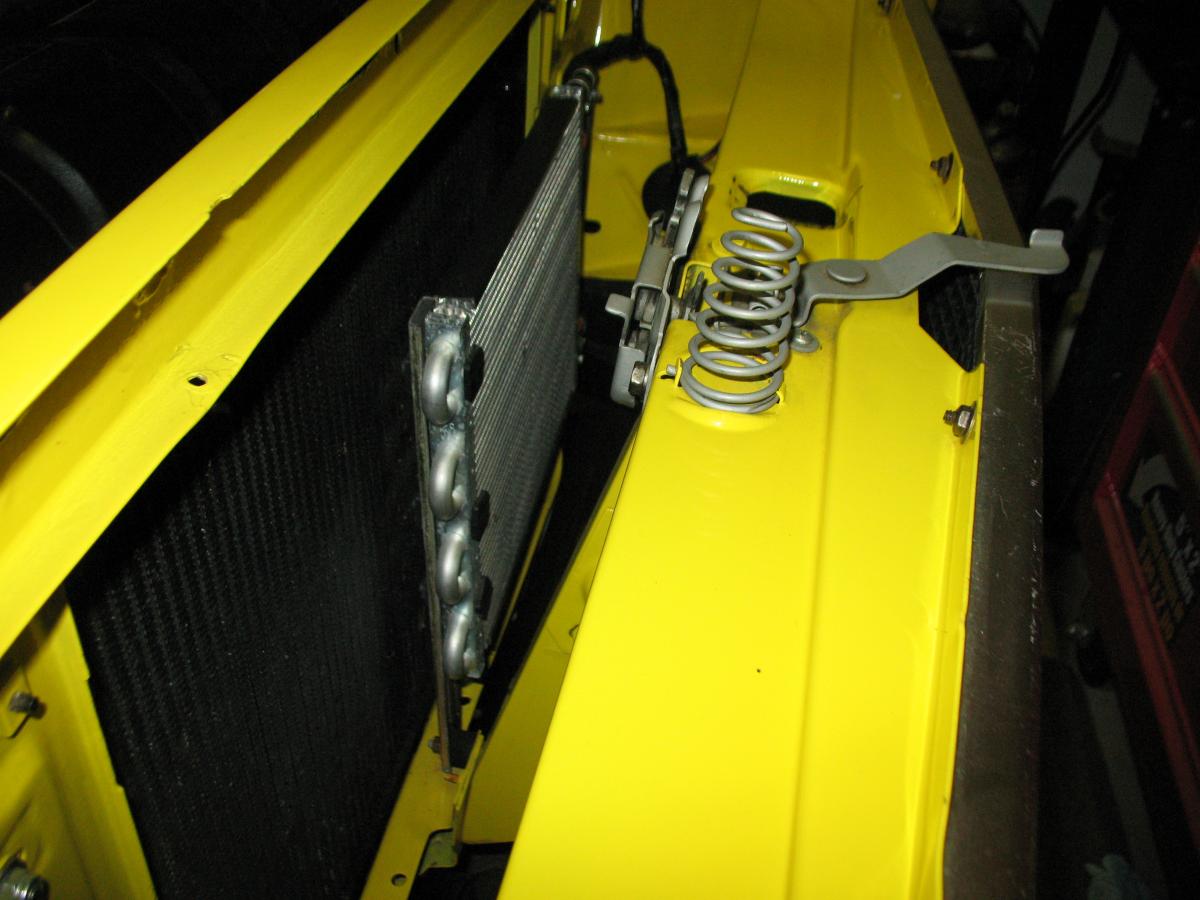

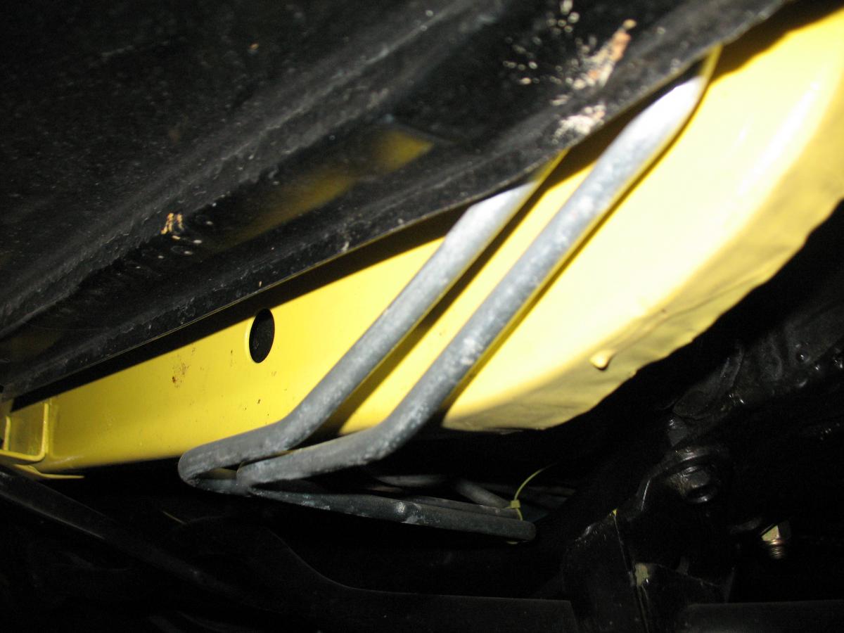

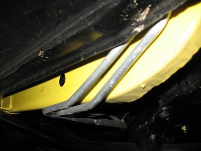

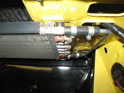

Like Ron,I used the existing trans lines and fabbed a line from the cooler outlet on the rad to the trans cooler and coupled a return line to the trans. I used rubber isolators and clamps to existing holes in the rad cradle and din rail to support the opposite side.The cooler sits approximately 1 " from the radiator.
