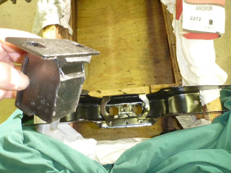

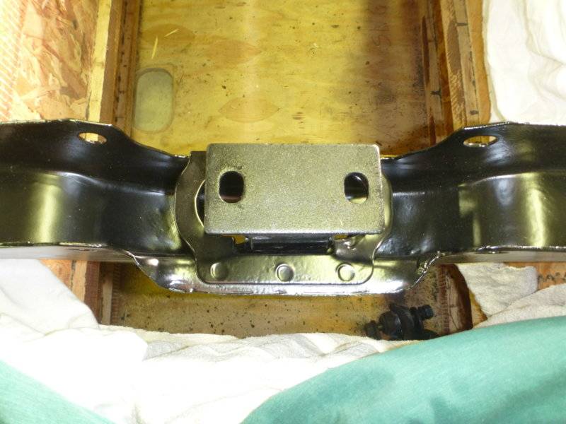

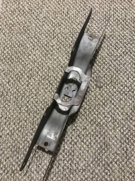

Which side faces forward??????? 68 Charger R/T 4 speed

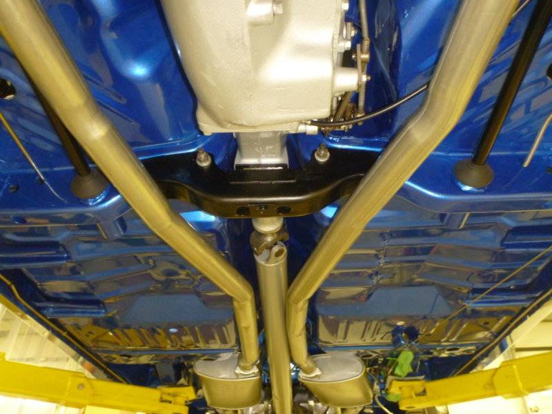

I hope I did mine right,flange forward.
Flange to the rear is the way it came off and went back on my car and everything lined up. Not saying that is correct, but fairly certain that it is. Either way the rubber mounts upper bolt flange will still be in the same place.

It will go either way, it's concentric mount hole wise. Looks like Justin has his GTX opposite to mine and how Dave says he mounted his. Maybe I got mine turned around. Hopefully some others chime in as to which is definitely correct. I need to drop my trans and look for a fluid leak anyhow and if necessary will turn mine around then.

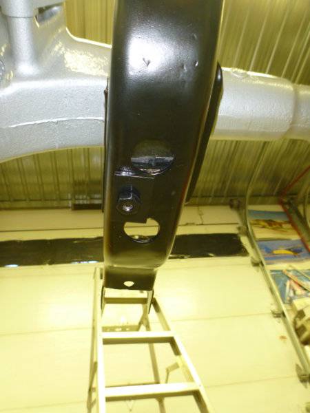

Here is the one in my ex '70 GTX....
I'm not 100% sure, but are there different tailshaft housings - that would make a mounting difference.
Flange lip to the rear, mount nut to the front

Flange to the rear on all my cars.
:BangHead: thats how my week is going. 12 days and still waiting for flange gaskets.
Thank you everyone! Flange to the rear. So does it make my Charger a “winged car”???
