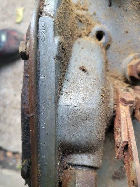

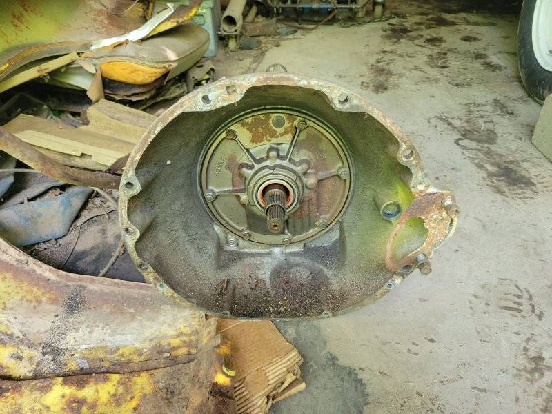

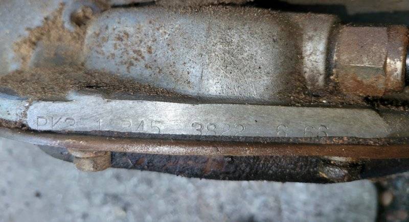

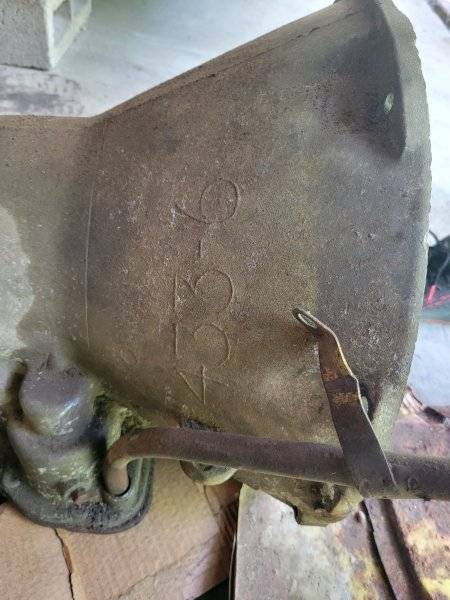

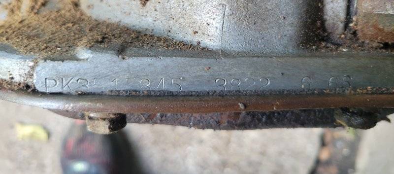

can anyone tell what transmission this is? Pulled from my 72 charger.
(P)passenger? (K) Kikomo Plant # 3515845 Standard duty trans for both 1971 and 1972, for both 383 ('71) & 400 (72) motors. If you Charger was original 400 car, just maybe the original trans.
