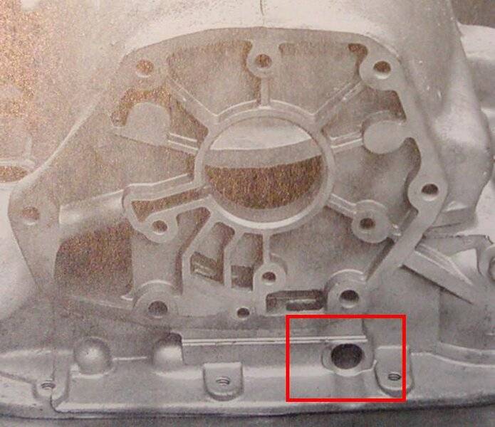

Usually 3 places as mentioned. Gasket, dip tube, or shaft seal.
Or the often overlooked rear band pivot shaft.
