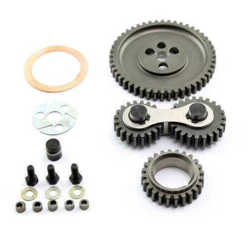

What do you know about the engine? Could it have a gear drive? That’s sort of what it sounds like to me.
I do t know much about the build, was built for drag racing. Ill look into it, but what is a gear drive?
Cam is driven by a set of gears (that whine as they are straight cut) instead of sprockets and chain which is quieter.
