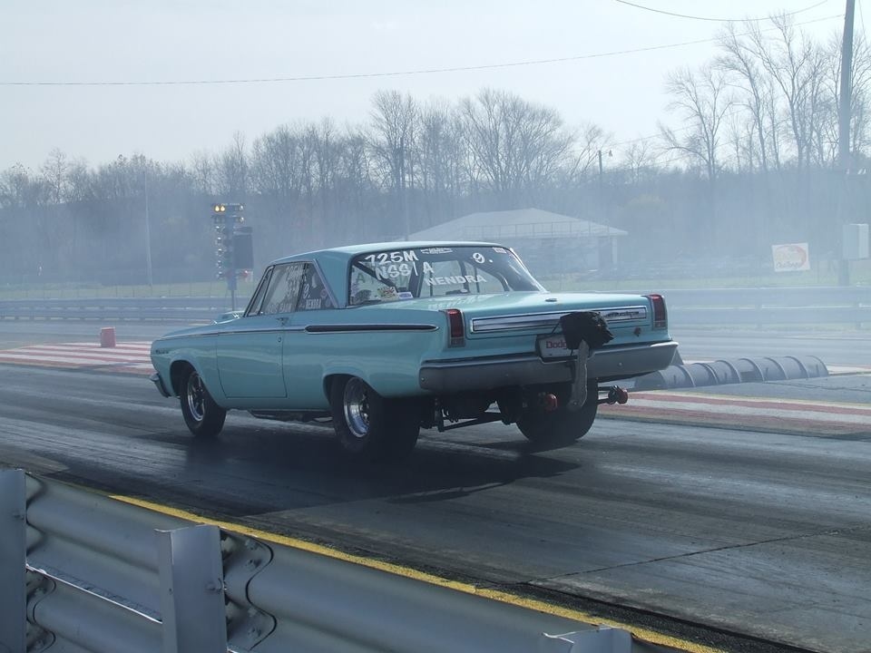

My 65 light blue dodge coronet. 4.30 gears & M/T 31 x 10.5W goes thru the traps at 7400 rpms at 155.12 605 ci hemi
My 65 Plymouth Belvedere same gears and tires goes through the traps at 7000 at 150.22 605 ci hemi also
Both have 8" converters. So your results will vary.
