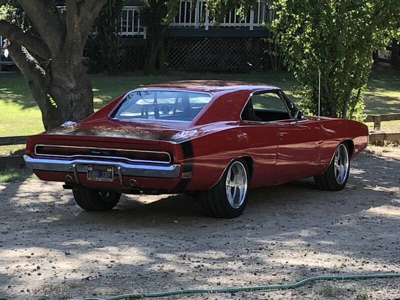

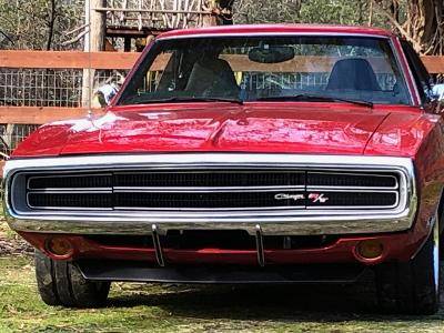

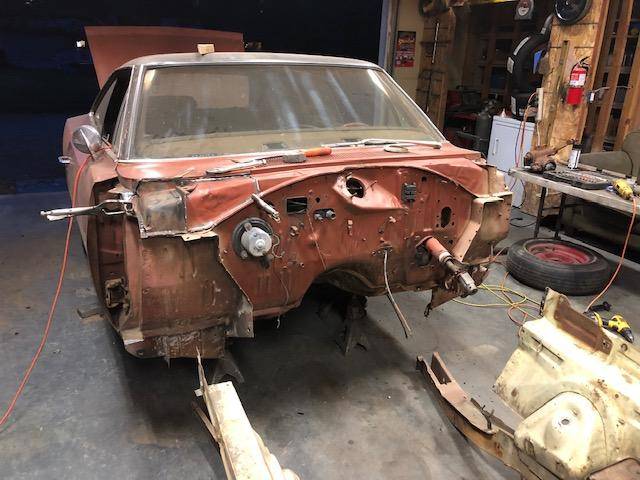

I am finally going to do it. The 727 is coming out and a Tremec TKO600 is going in.

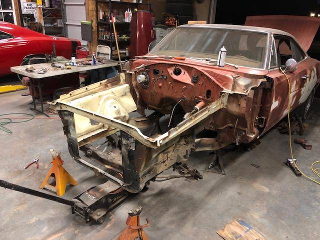

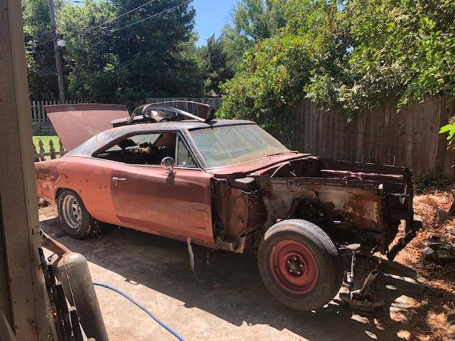

September 2019, I bought THIS fine car:

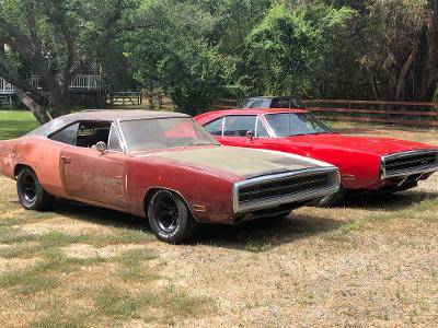

The car came with the original 383 but was missing a LOT of parts. I rebuilt the engine but needed a good 727, converter, drive shaft, cooler and lines, shift linkage and Kickdown linkage or cable.

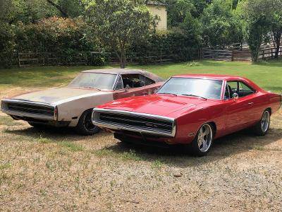

I got to the point where I needed to buy all that stuff to get "Jigsaw" running and driving.
The thing is, I already have all of those parts in excellent working order....currently in THIS car:

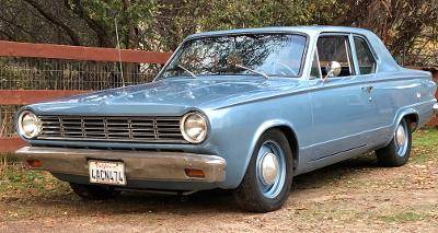

For this transmission swap, I am selling THIS car:
The Dart is the proverbial "Fell into my lap" car. December 2015, a car club buddy called me..."Hey, do you know anyone that might want a '65 Dart? $600 and it comes with a bunch of parts!"
Yeah...I know a guy.
I sold the parts....which paid for the car entirely. I had it on ebay before Christmas and it didn't make the reserve. I'll try again soon.

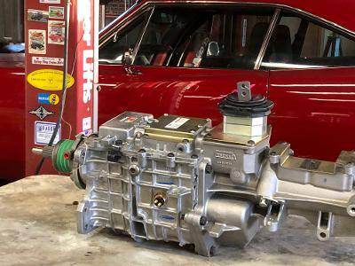

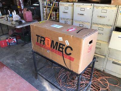

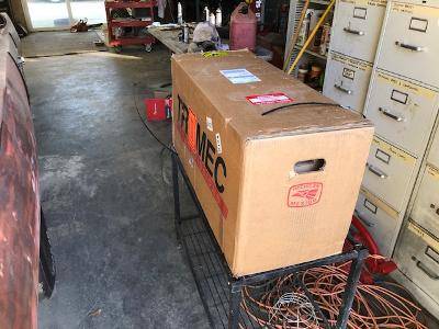

I placed the order in early December. The TKO series seems to be fading out as the new TKX (or whatever the new one is called) is gaining popularity. This may have been why the price I paid was far lower than the quote I got in early 2019....It was like buying day old donuts that still tasted fine!

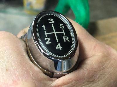

For $5978 I got the whole she-bang. TKO600 series in the Close ratio. 1st: 2.87 2nd: 1.89 3rd: 1.28 4th: 1.0 5th .64. Hydraulic clutch. Pedals, bell housing, Pistol Grip lever, steel flywheel, SST TRK clutch, electronic speed sensor, floor plate and a bunch of other small parts.
The transmission arrived first, one of 6 boxes to arrive.

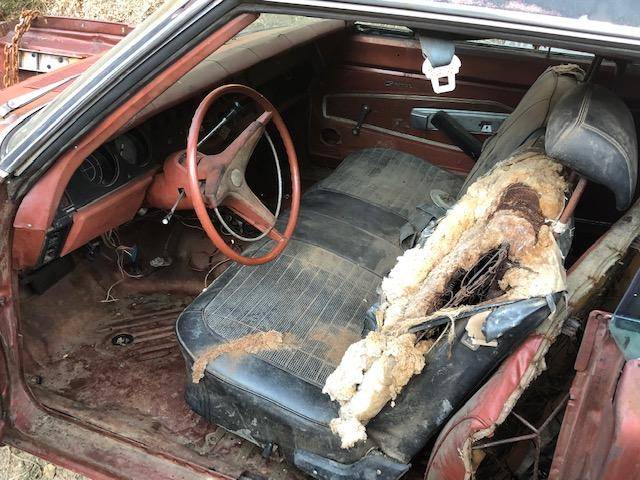

Jigsaw has a bench seat and column shift for now but I do have a bare console and bucket seats that will make their way into the car eventually.
Yeah, it looks like crap...I am quite aware of that!

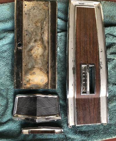

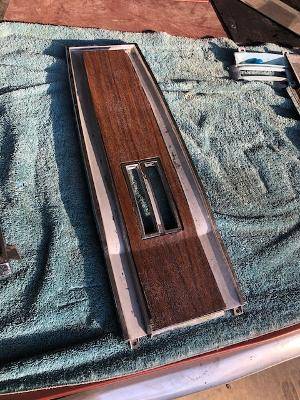

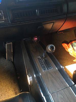

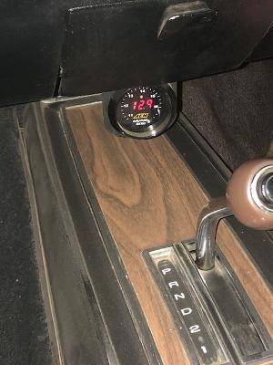

The spare console that came with "Jigsaw" really is bare....NO carpet or border trim, no courtesy lights and NO top plates. Ginger has all of those things in good condition. More parts sharing! Here is the console in Ginger:

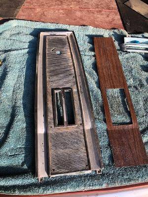

I will be keeping a console in Ginger. I knew that the automatics and the 4 speed cars used a different top plate for the console. This SST kit is supposed to put the shifter in the stock location as the 4 speed cars. 4 speed stuff is harder to find but I have read from others that have taken A/T console plates and just modified the opening. Great idea!
A FBBO member came through with a fair price on some console parts:
