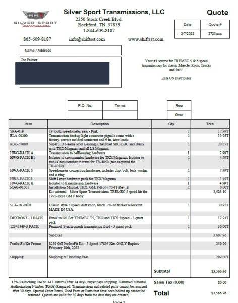

It's not that bad if you already have the 4 speed set up. My Quote from SilverSport for the Bee was $5100 with me getting my own clutch.
I went with the kit for the '74 Z/28 (as we drive it alot more) with a hydraulic clutch and everything for a touch under $3600 (still need to have driveshaft made (for an extra $500)
A bargain in my mind....

Did you mean for the Z28 install?
If so, no need as it bolt directly to the stock bell housing, will re-use my original flywheel and pressure plate (only need to purchase a disc as my clutch is new), comes with the shifter installed (will reuse my Hurst comp plus handle), and the hydraulic clutch is already in the quote....$3600 done...(plus clutch disc and drive shaft mods)

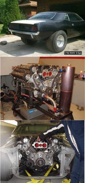

I have talked with Tremec on a possible 6 speed for a very serious E-body Pro Street build. 1200 HP at 1100 ft/lb. On pump gas N/A. They were the only transmission vendor even willing to take a shot. That new 6 speed. With some after production mods and gear polish.
Power is out running transmission options. Lenco would be an obvious contender. But that's defeating the purpose of a full manual transmission option. So still nosing around on any transmission thread.
