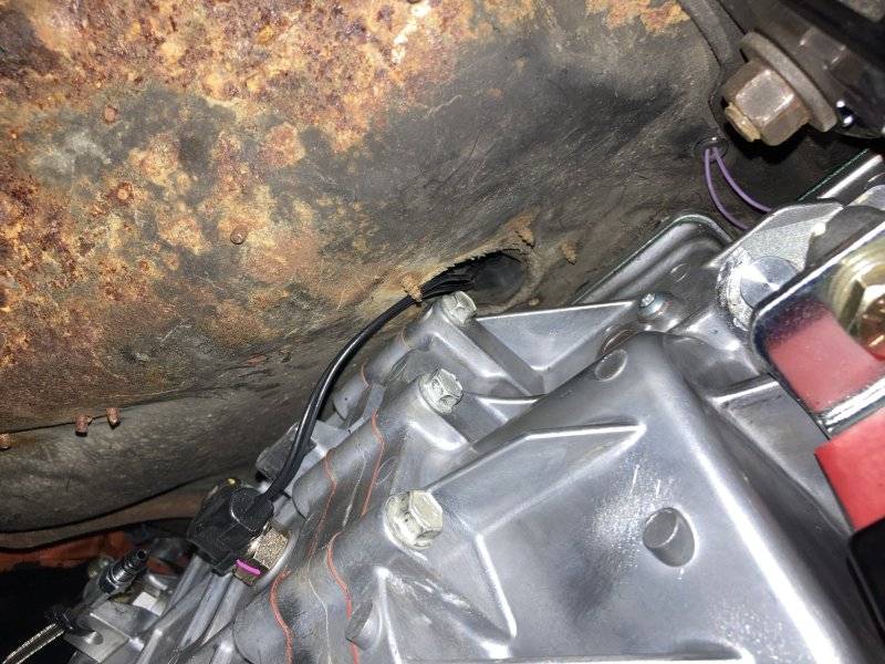

It’s hard to tell what’s going on here, but these are a couple of pics of the driver’s side of the trans, fully installed. The passenger side seemed to have better clearance than the driver’s side. No cutting necessary.
It is a nice transmission and is much smaller than the older Tremecs, but for a B body Mopar, you still need to cut up your transmission tunnel to make it work. I spoke with a Tremec guy at Carlisle who confirmed this.

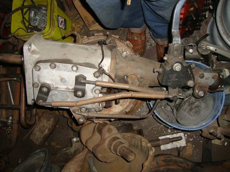

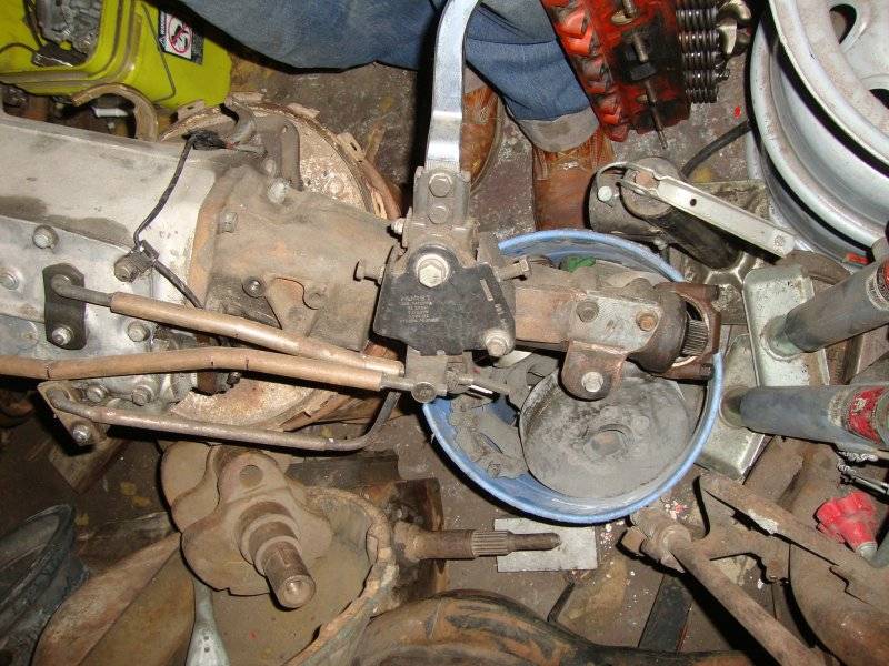

Yes, the Passon A-855 took me 5 years of waiting to get (prior to that I used a cast iron A-833 with OD gears and the shitty 3.09 1st gear). But, once I got it, it dropped in place using all my stock parts, with the shifter in the stock location. I love it - it works beautifully.

The only hole I had to cut was for the shifter. I had to remove a couple of screws from the rubber boot for the A-904 shifter rod for clearance, but I did not have to cut anything to clear the transmission housing.
I realize I used the wrong phrase by saying "cut up the transmission tunnel". As you stated, the shifter cannot be in the stock location so you need to cut a hole in the transmission tunnel for it. Obviously, on a manual car, the original shifter hole needs to be covered up as well.

But all stock parts are used. The stock bellhousing, stock driveshaft, shift linkage, etc. You can swap an A-855 for an 18 spline A-833 simply by swapping the transmission. That's it. There is no other work needed to install it. No holes to cut, no tunnels to modify, no driveshafts to shorten or lengthen. And I can swap back and forth between the A-855 and my numbers matching A-833 in about 3 hours.
