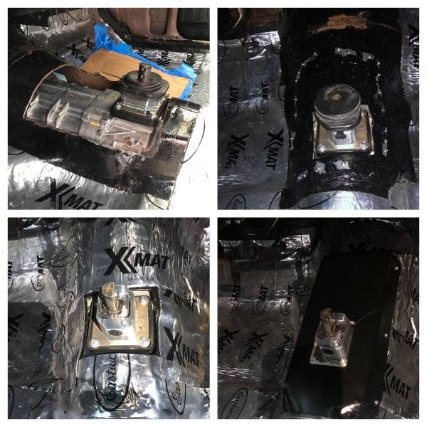

TREMEC TKX fitment verified!

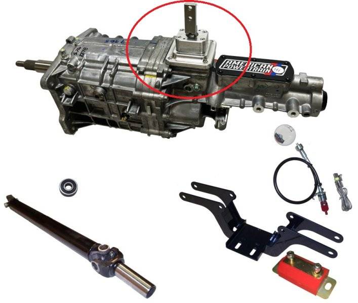

According to SST no, you don't need to cut the floor or cross member in a 68-70 B body, 70--74 E body or a 71-74 B Body console car. However you will need to cut floor and use a different trans mount or extend the hump/opening back to the console location in a 71-74 B Body bench seat car.
Am looking to do the same swap and after talking with them that's what I learned.

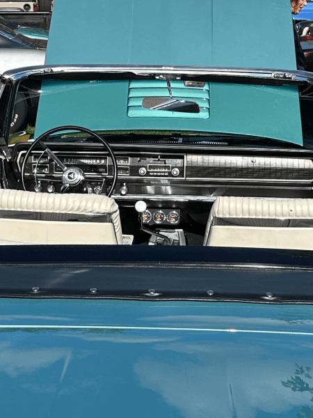

He didn't mention if the shifter would actually go through the stock 4 speed hole location. I wonder????
The shifter can be rotated 180 to move handle forward or rearward. It will be centered as opposed to side mounted. A custom bent handle could probably be the solution.
