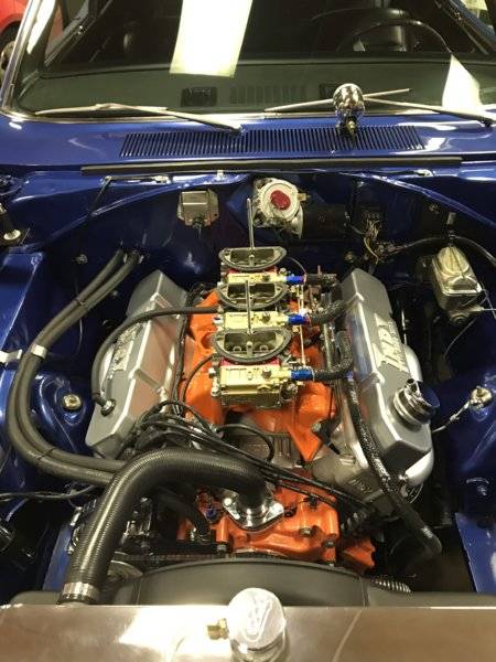

@Sonny , if you are thinking of using three of those 80683 carbs, i dont think that will work. The mopar sixpack manifold is spaced for a middle carb with a metering block, and end carbs with a metering PLATE. The front carb would fit but the rear will not have enough room, because of the added thickness of the metering block . I think the ford carbs, and the aftermarket mopar carbs that were mechanical secondary used metering plates too. The corvette carbs were vacuum secondary.
I see that now. Thanks for the heads up!

It appears all 3 of your carbs have metering blocks. Mopars have metering plates on out boards only. There’s not enough room for a metering block on the rear carb. How did you handle this?
Sonny
