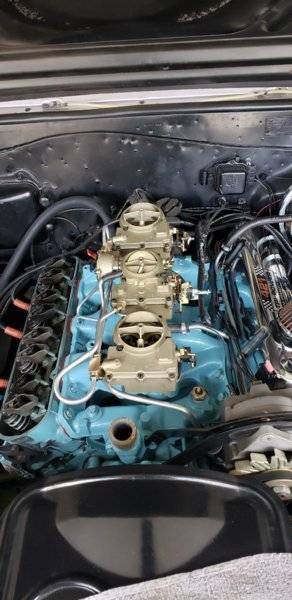

Where did you find that? I wish I never sold my original Edelbrock one.Holley mechanical linkage.
Well...that's a nice setup!What about this ?
Does the stock six pack air cleaner base clear the fuel line connections on top of the side hung bowls?

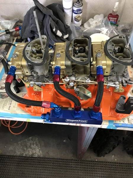

VERY NICE! LOVE THE FUEL BLOCK! Who makes the fuel block? I can't read it.

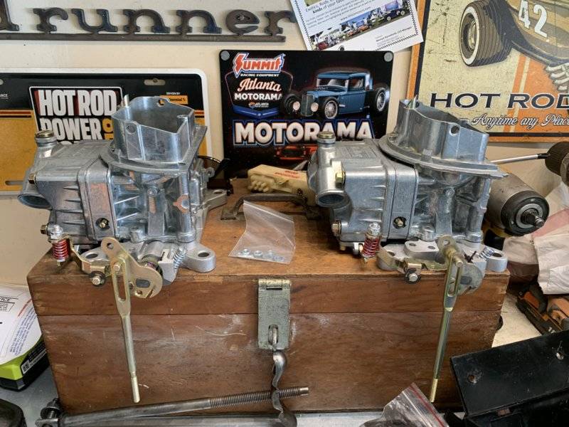

In order to create the clearance needed in between the rear and center carb, will this mechanical secondary carb accept a metering plate in lieu of using a side hung bowl? I’d like to keep all 3 fuel lines on the passenger side and the side bowl won’t allow that. I realize it would give up the ease and convenience of individual jets in the metering block. View attachment 932213
Potential dumb question alert: What if I just use the idle circuit on the center carb? Still no bueno? I was just referring to the outboard carbs.no it will not, you’ll have no way to meter the fuel to the idle circuit.

Thanks. Can you tell me the thread size for the side hung bowl’s fuel inlet?no bueno
I’m only checking because these new carbs are 1/2 the price of the used vacuum Holleys for Mopar.
The trouble with trying to save one Buck is that it usually costs two Bucks to do it.....not counting the aggravation.
ABSOLUTELY TRUE.....words of wisdom....perhaps Sonny will rethink his position and just buy what he wants/needs and just enjoy the car and forget about trying to put "a square peg in a round hole" both literally and figuratively.....The trouble with trying to save one Buck is that it usually costs two Bucks to do it.....not counting the aggravation.
I don’t disagree with your thinking. So far I have all 3 new Holley 2300 carbs (325 cfm center and 2 350 cfm outboards) mech linkage, 1 side hung bowl, new Edelbrock intake, and an assortment of -6an fittings all in for $1500. That’s less than 3 new Mopar carbs and/or used ones that are risky and need rebuilding alone. 3 new Mopar vac carbs plus intake is over $2200.ABSOLUTELY TRUE.....words of wisdom....perhaps Sonny will rethink his position and just buy what he wants/needs and just enjoy the car and forget about trying to put "a square peg in a round hole" both literally and figuratively.....
